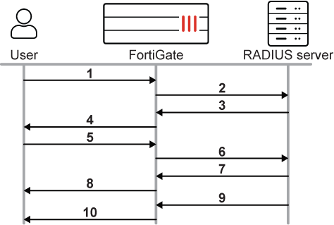

When a user logs in to two devices through RADIUS authentication. The authentication and authorization flow is as follows:
  1. The user logs in to a device and the authentication is sent to the FortiGate.
  2. The FortiGate sends the Access-Request message to the RADIUS server.
  3. The RADIUS server sends the Access-Accept message to the FortiGate. The server also returns the WISPr-Bandwidth-Max-Up and WISPr-Bandwidth-Max-Down VSAs.
  4. Based on the VSA values, the FortiGate applies traffic shaping for the upload and download speeds based on its IP.
  5. The user logs in to a second device and the authentication is sent to the FortiGate.
  6. The FortiGate sends the Access-Request message to the RADIUS server.
  7. The RADIUS server sends the Access-Accept message to the FortiGate. The server also returns the WISPr-Bandwidth-Max-Up and WISPr-Bandwidth-Max-Down VSAs at half the value from the first device.
  8. Based on the VSA values, the FortiGate applies traffic shaping for the upload and download speeds on the second device based on its IP.
  9. The RADIUS server sends a CoA message and returns WISPr-Bandwidth-Max-Up and WISPr-Bandwidth-Max-Down VSAs for the first device at half the value.
  10. Based on the VSA values, the FortiGate updates traffic shaping for the upload and download speeds on the first device based on its IP.

A FortiGate can use the WISPr-Bandwidth-Max-Down and WISPr-Bandwidth-Max-Up dynamic RADIUS VSAs (vendor-specific attributes) to control the traffic rates permitted for a certain device. The FortiGate can apply different traffic shaping to different users who authenticate with RADIUS based on the returned RADIUS VSA values. When the same user logs in from an additional device, the RADIUS server will send a CoA (change of authorization) message to update the bandwidth values to 1/N of the total values, where N is the number of logged in devices from the same user.
This feature is not supported by FortiGates with NP6, NP6Lite (SoC3), or NP6XLite (SoC4) processors. NP6 offloading is automatically disabled on the policy if this feature is enabled. This feature is supported by FortiGates with NP7 and NP7Lite (SoC5) processors.
