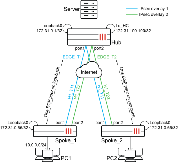

The SD-WAN topology with ADVPN and BGP neighbor on loopback is used for the following two examples:
Example 1: Embedded priority configuration
In this example, a health check named hub is configured to embed its measured health status. When the health check is in SLA, the spoke sends an in-SLA priority of 10. When it is out of SLA, the spoke sends an out-of-SLA priority of 100. As there are two link-cost-factor thresholds (latency: 100, packet-loss: 50), the spoke sends in-SLA only if both factors are satisfied.
To configure the example:

      The following example shows:
      • rmt_ver=2 indicates that SLA information, SLA status, and overlay priority have been received.
      • rmt_sla=out indicates that received SLA status is out of SLA.
      • rmt_sla=in indicates that received SLA status is in SLA.
      • rmt_prio indicates the received overlay priority value.
      • EDGE_T1_0 is to H1_T11 on Spoke_1, and EDGE_T1_1 is to H1_T11 on Spoke_2.
      • EDGE_T2_1 is to H1_T22 on Spoke_1, and EDGE_T1_0 is to H1_T22 on Spoke_2.

  4. After the spokes' overlay priorities are embedded in ICMP probes and transported to the hub, view the routing tables on the hub.
    The hub sets overlay priorities on IKE routes over EDGE_T1 and EDGE_T2. Meanwhile, recursively resolved BGP routes inherit the priorities from those IKE routes.

Examples

    config system speed-test-schedule edit "H1_T11" set mode TCP set schedules "speed-test" set dynamic-server enable set ctrl-port 6000 set server-port 7000 next edit "H1_T22" set mode UDP set schedules "speed-test" set dynamic-server enable set ctrl-port 6000 set server-port 7000 next end
Before starting the speed test on Spoke_1, route priorities are based on the received overlay priorities on both H1_T11 and H1_T22
HUB (root) (Interim)# get router info routing-table bgp
Routing table for VRF=0
B       10.0.3.0/24 [200/0] via 172.31.0.65 (recursive via EDGE_T1 tunnel 10.0.0.20 [10]), 00:11:56
                                            (recursive via EDGE_T2 tunnel 172.31.0.65 [15]), 00:11:56, [1/0]
While the speed test is running on H1_T11 of Spoke_1, Spoke_1 will constantly embed out-of SLA overlay priority into probes on H1_T11 and send them to the hub. Then the Hub updates route priorities accordingly and detours hub-to-spoke traffic to H1_T22 to avoid the impact on speed test of H1_T11. EDGE_T2 is preferred, and the EDGE_T1 priority changed from 10 to 20.
Routing table for VRF=0Routing table for VRF=0
B       10.0.3.0/24 [200/0] via 172.31.0.65 (recursive via EDGE_T2 tunnel 172.31.0.65 [15]), 00:03:49
                                            (recursive via EDGE_T1 tunnel 10.0.0.20 [20]), 00:03:49, [1/0]
During the speed test on H1_T22 of Spoke_1, Spoke_1 constantly embeds out-of SLA overlay priority into probes on H1_T22 and sends them to the hub. Then the Hub updates route priorities accordingly and detours hub-to-spoke traffic to H1_T11 to avoid the impact on speed test of H1_T22. EDGE_T1 is preferred, and the EDGE_T2 priority changed from 15 to 25.
B       10.0.3.0/24 [200/0] via 172.31.0.65 (recursive via EDGE_T1 tunnel 10.0.0.20 [10]), 00:04:06
                                                                  (recursive via EDGE_T2 tunnel 172.31.0.65 [25]), 00:04:06, [1/0]
Once speed test completes, the results are applied on child tunnels as egress-shaping-profile on the hub.
