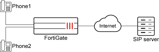

Example
In this example, SIP ALG is required for pinhole creation, handling NAT, and controlling SIP messages that requires flow-based SIP. The administrator needs to configure two SIP profiles, one with each feature set (voipd and ips), and apply these SIP profiles in the same firewall policy.
To configure SIP ALG with SIP IPS:
  1. Configure the VoIP profiles:
    config voip profile
        edit "voip_sip_alg"
            set feature-set voipd
            set comment "sip_alg_simple"
            config sip
                set log-violations enable
                set log-call-summary enable
        edit "voip_sip_ips"
            set feature-set ips
            set comment "ips_voip_blocking"
            config sip
                set block-invite enable
  2. Configure the firewall policy:
    config firewall policy
            set srcintf "port1"
            set dstintf "port9"
            set srcaddr "all"
            set dstaddr "all"
            set srcaddr6 "all"
            set dstaddr6 "all"
            set service "ALL"
            set utm-status enable
            set inspection-mode proxy
            set ips-sensor "g-default"
            set voip-profile "voip_sip_alg"
            set ips-voip-filter "voip_sip_ips"
            set logtraffic all
            set nat enable
To verify the SIP proxy SIP calls:
  1. Verify the register request:
    # diagnose sys sip-proxy calls
    sip calls
      vdom 1 (vdom1) vrf 0 call 7f2b99828300
        call-id: 619216389
        txn 7f2b998ad600 (REGISTER)
          cseq 2 dir 0 state 5 status 200 expiry 527 HA 0
          i_session: 7f2b998aac00  r_session: 7f2b998aac00
          register: present
          from: sip:2001@172.16.200.44
          to: sip:2001@172.16.200.44
          src: 10.1.100.11:5060
          dst: 172.16.200.44:5060
