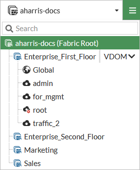

  • Users can navigate to downstream FortiGate devices and VDOMs directly from the root FortiGate using the Fabric selection menu.
  • The logical topology shows all of the configured VDOMs.

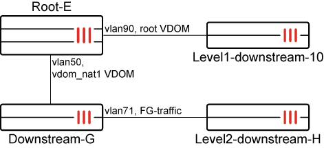

In this topology, there is a root FortiGate with three FortiGates connected through two different VDOMs. The root FortiGate is able to manage all devices running in multi-VDOM mode.

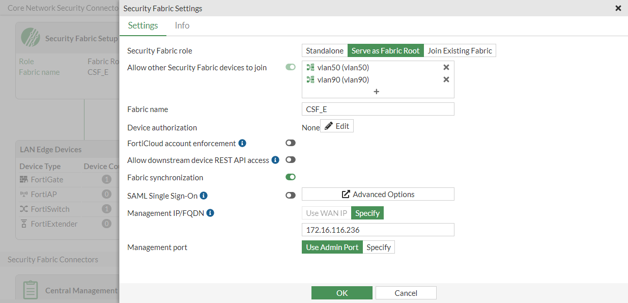

To configure Root-E in the GUI:
  1. Go to Security Fabric > Fabric Connectors and double-click the Security Fabric Setup card.
  2. Set the Security Fabric role to Serve as Fabric Root.
  3. Enable Allow other Security Fabric devices to join and click the + to add the interfaces (vlan50 and vlan90) from the vdom_nat1 and root VDOMs.
  4. Configure the other settings as needed.
  5. Click OK.

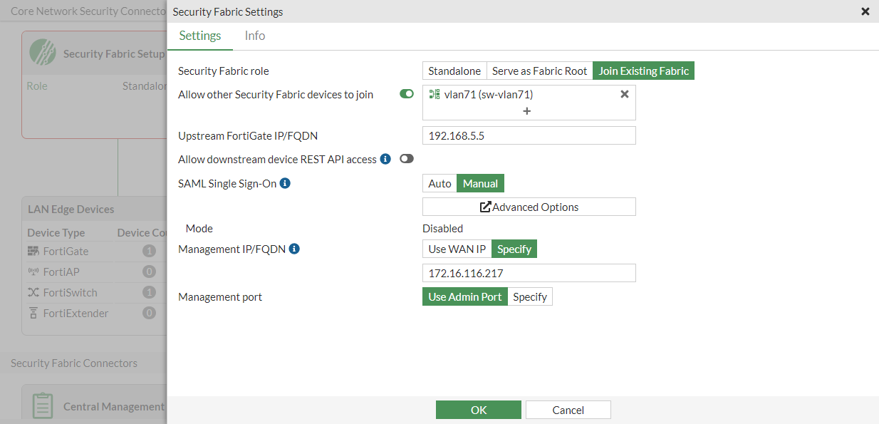

To configure Downstream-G in the GUI:
  2. In the Settings tab, set the Security Fabric role to Join Existing Fabric.
  3. Enter the Upstream FortiGate IP, which is the IP of the root FortiGate vdom_nat1 interface (192.168.5.5). Downstream-G must use the interface from the management VDOM to connect to the upstream FortiGate IP.
  4. Enable Allow other Security Fabric devices to join and click the + to add the downstream interface (sw-vlan71) from the FG-traffic VDOM.
  5. Configure the other settings as needed.
  6. Click OK.

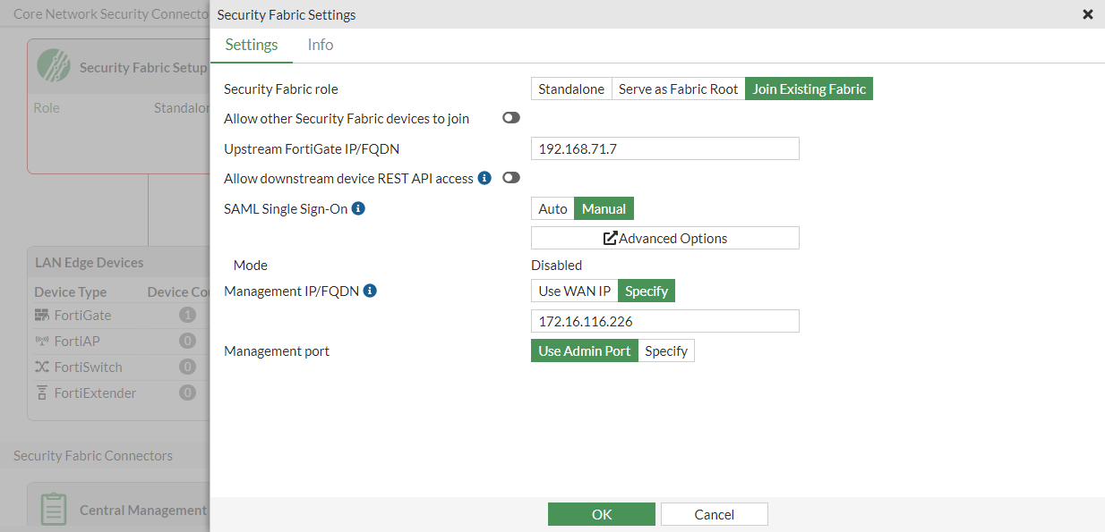

Downstream FortiGate 2 (Level2-downstream-H)
To configure Level2-downstream-H in the GUI:
  3. Enter the Upstream FortiGate IP, which is the IP of the root VDOM on Downstream-G (192.168.71.7).
  5. Click OK.

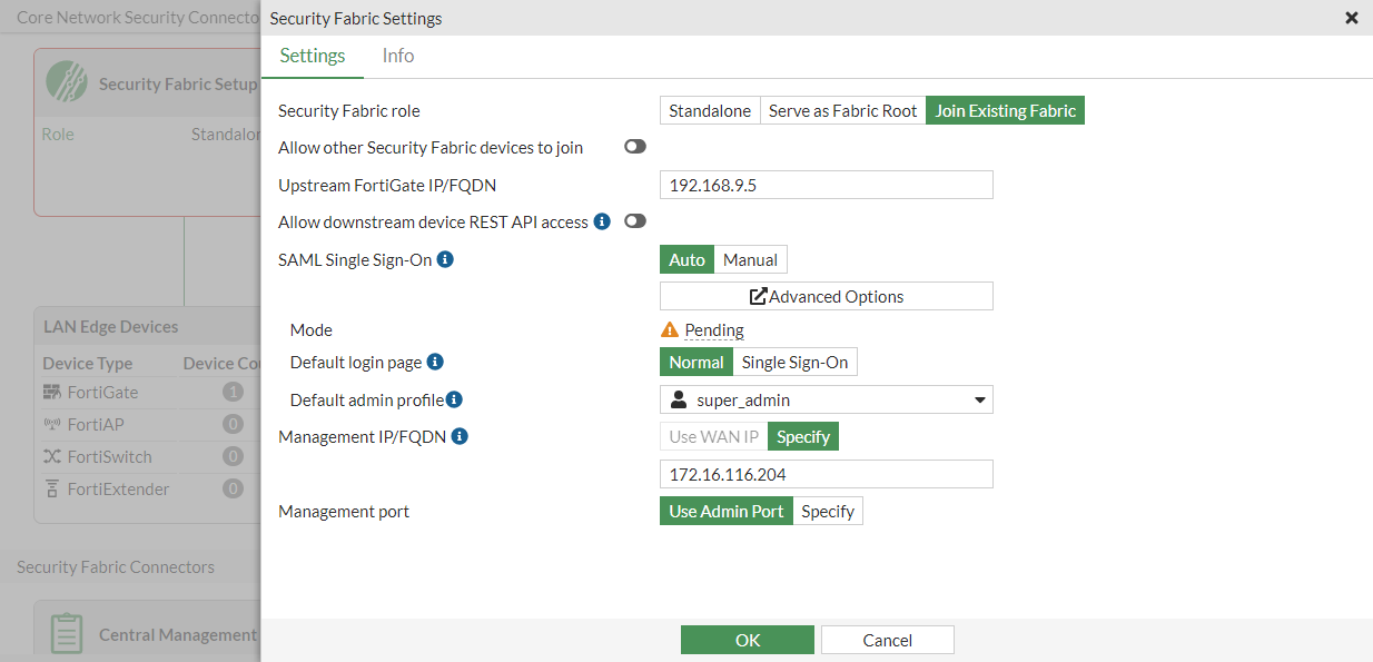

To configure Level1-downstream-10 in the GUI:
  3. Enter the Upstream FortiGate IP, which is the IP of the root VDOM on Root-E (192.168.9.5).
  5. Click OK.

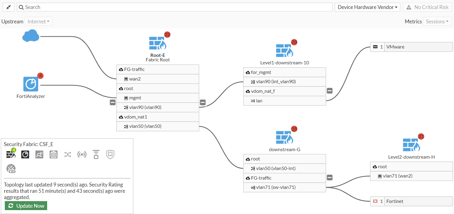

    Once all the devices are authorized, the physical topology page shows the root and downstream FortiGates. The logical topology page shows the root and downstream FortiGates connected to interfaces in their corresponding VDOMs.
  5. Click OK.
