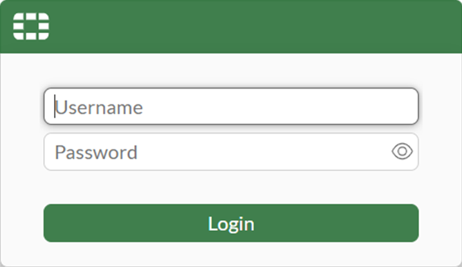

To log in to FortiOS GUI:
  1. In a web browser, go to https://192.168.1.99.
    By default, the management interface or the internal interface is configured to allow HTTPS access with the IP address 192.168.1.99.
    The login page is displayed in your browser.
  2. Log in:
    • In the Username field, enter admin.
    • leave the Password field blank.
    • Click Login.

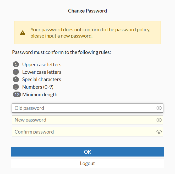

    The Change Password dialog box is displayed.
    Starting in FortiOS 7.6.5, the password policy is enabled and enforced. You must change the admin password to meet the policy requirements. See also Password policy.
  3. Change the password and click OK. The login page is displayed again.

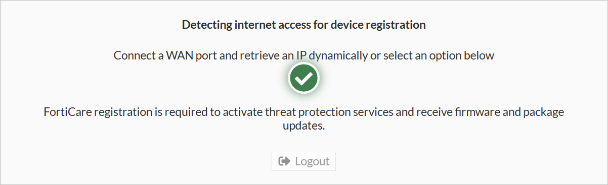

The Detecting internet access for device registration dialog box helps you configure internet access for the FortiGate to prepare for device registration to FortiCare.
To configure internet access:
  1. While the Detecting internet access for device registration dialog box is displayed, use an Ethernet cable to connect the WAN port on the FortiGate to an upstream router, switch, or modem with access to the internet.
    If you have already connected an Ethernet cable, unplug the cable, and plug it in again.
    Internet access is available when the FortiGate model has addressing mode set to DHCP by default on the WAN interface, and the WAN interface is connected to a network with a DHCP server assigning the correct IP and gateway for internet access.

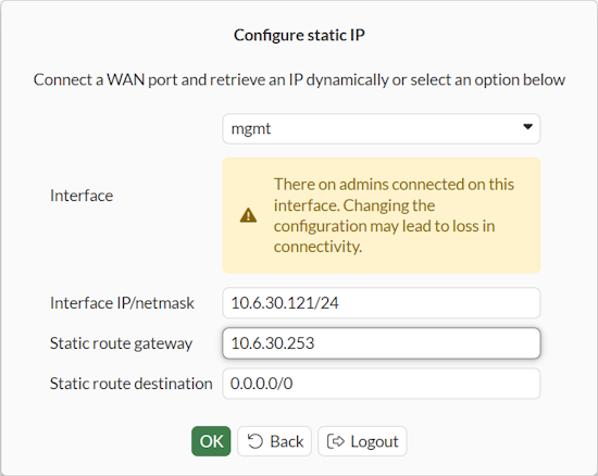

  2. If FortiGate does not connect to the internet, configure the interface IP address and gateway using the GUI or CLI:
    • For the GUI:
      1. Select Configure static IP. The Configure static IP dialog box is displayed.
      2. Configure the options, and click OK.
    • For the CLI, select CLI setup to configure the interface IP address and gateway:
      config system interface
          edit <interface>
              set mode static
              set ip <address> <netmask>
      config router static
          edit 0
              set gateway <gateway IP>
              set device <interface>
    When FortiGate connects to the internet, the GUI displays the following page:

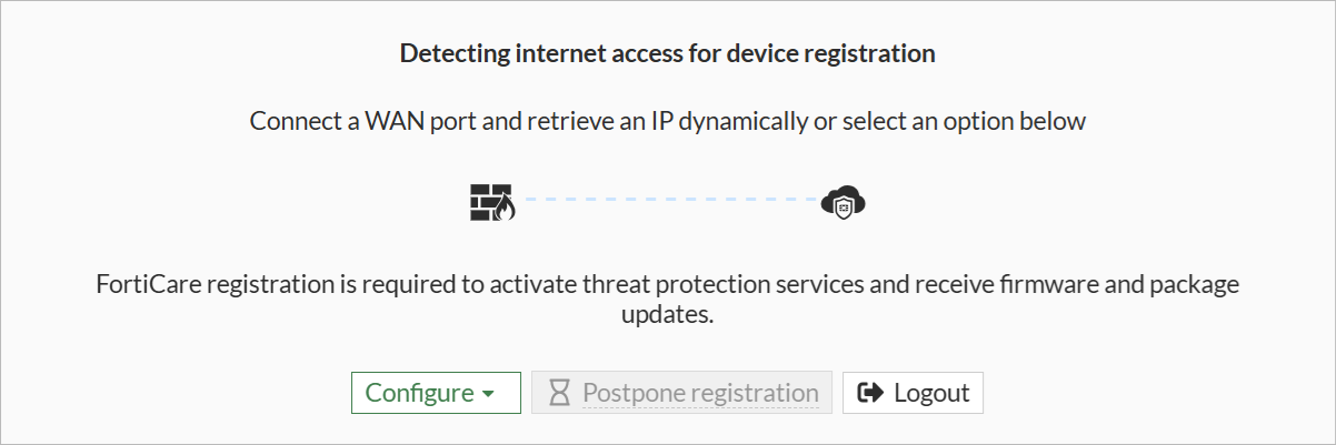

Click the Postpone registration button on the following dialog boxes to access the seven-day setup period:
  • The Detecting internet access for device registration dialog box when FortiOS detects no internet access for FortiGate
  • The Register with FortiCare dialog box when FortiOS detects internet access for FortiGate and automatically proceeds to this screen

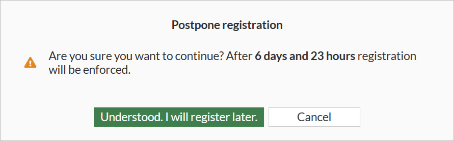

To postpone registration and access the setup period:
  1. After logging in to FortiOS for the first time and the Detecting internet access for device registration dialog box is displayed, click Postpone registration.
    The Postpone registration dialog box is displayed. It shows 6 days and 23 hours of FortiGate uptime remain until registration is required.
  2. Click Understood, I will register later.
    The FortiGate Setup wizard is displayed.
  3. Click Later to proceed to the GUI and configure the device.

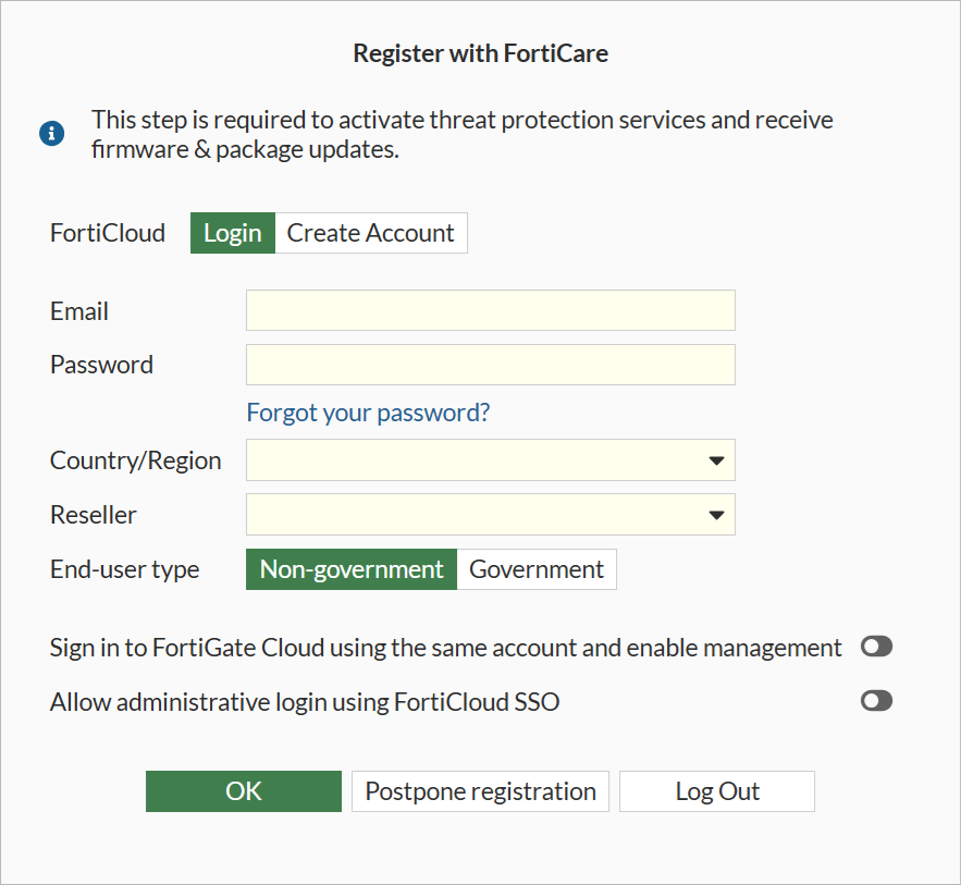

To postpone registration from the Register with FortiCare dialog box:
  1. After logging in to FortiOS for the first time and FortiOS detects an internet connection, a confirmation dialog box is displayed. :
    Then the Register with FortiCare dialog box is displayed.
  2. Postpone registration:
    1. Click Postpone registration.
      The Postpone registration dialog box is displayed with the remaining setup time.
  3. After the seven-day setup period ends, the Postpone registration button is no longer available, and you must register with FortiCare or log out.
  2. Log in:
    • Click Login.

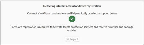

    • For the GUI:
          edit <interface>
              set mode static
          edit 0
