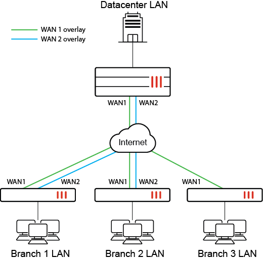

Topology
This topology is used in the following procedures:

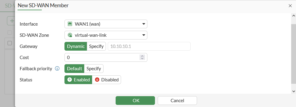

To configure the SD-WAN members and add them to the default zone in the GUI:
  1. Go to Network > SD-WAN, select the SD-WAN Zones tab, and click Create New > SD-WAN Member.
  2. Set the Interface to WAN1.
  3. Leave the SD-WAN Zone as virtual-wan-link.
  4. Click OK.
  5. Repeat these steps to create SD-WAN members for the WAN2, VPN1, and VPN2 interfaces.

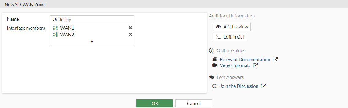

To configure the SD-WAN zones in the GUI:
  1. Go to Network > SD-WAN and select the SD-WAN Zones tab.
  2. Click Create New > SD-WAN Zone.
  3. Enter the Name, Underlay.
  4. Set the Interface members to WAN1 and WAN2.
  5. Click OK.
  6. Repeat these steps to configure the Overlay zone with members VPN1 and VPN2.
