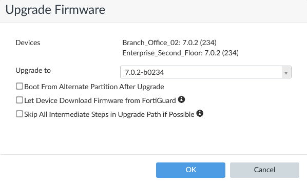

- Select one or more devices, and select Firmware Upgrade from the More menu.
The Upgrade Firmware dialog box opens.
- Configure the following settings, then click OK:
Upgrade to
Select a firmware version from the drop-down list.
Boot From Alternate Partition After Upgrade
Selecting this option causes the device to reboot twice during the upgrade process: first to upgrade the inactive partition, and second to boot back into the active partition.
Let Device Download Firmware from FortiGuard
Select this option to download the firmware directly from FortiGuard. If this option is not selected, FortiManager will download the firmware from FortiGuard. Alternatively, you can import the firmware into FortiManager.
Skip All Intermediate Steps in Upgrade Path if Possible
FortiManager manages the most optimum upgrade path automatically. Select this option to install the selected version directly without going though the upgrade path.

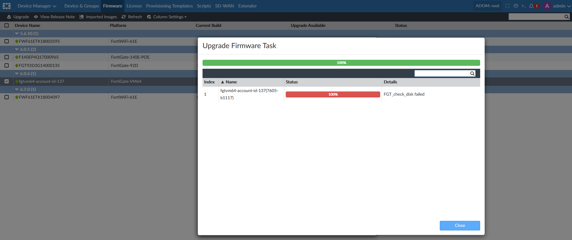

FortiManager checks the FortiGate disk before upgrading. If the check fails, the following information is displayed, and the upgrade is not performed:

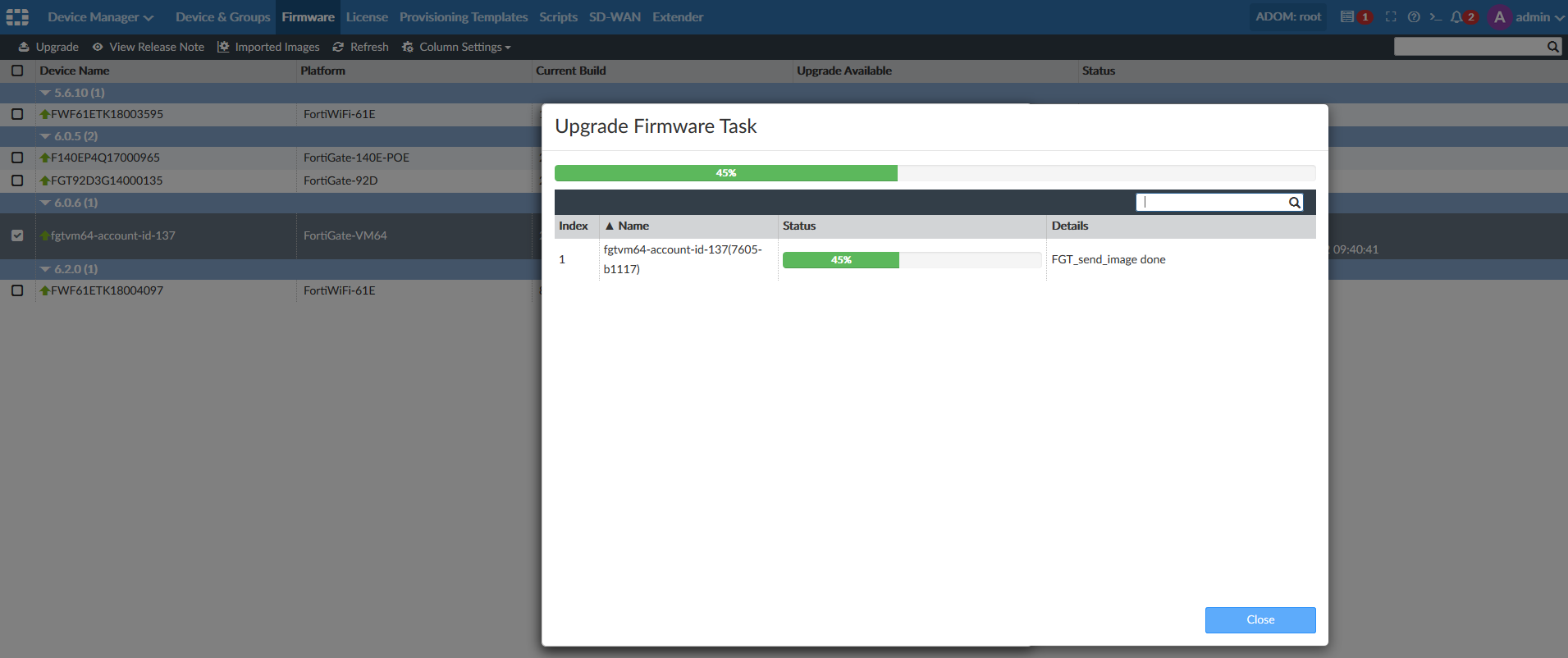

If the check passes, the upgrade proceeds:

The disk on the FortiGate is checked automatically before upgrade. To enable skip disk check run the |
To disable disk check:
- Disable disk check by using the CLI:
config fmupdate fwm-setting
(fwm-setting)# set check-fgt-disk disable
The default setting is enable, which will check the FortiGate disk before upgrading FortiOS.
