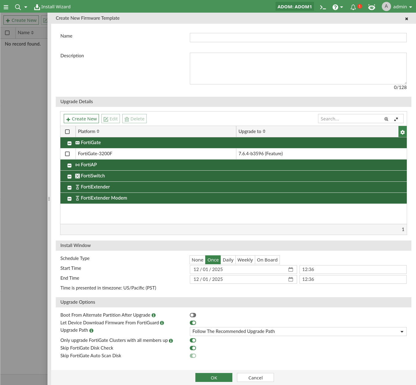

  1. Go to Device Manager > Firmware Templates.
  2. In the toolbar, click Create New.
    The Create New Firmware Template pane is displayed.
  3. In the Name box, type a name.
  4. Create upgrade details:

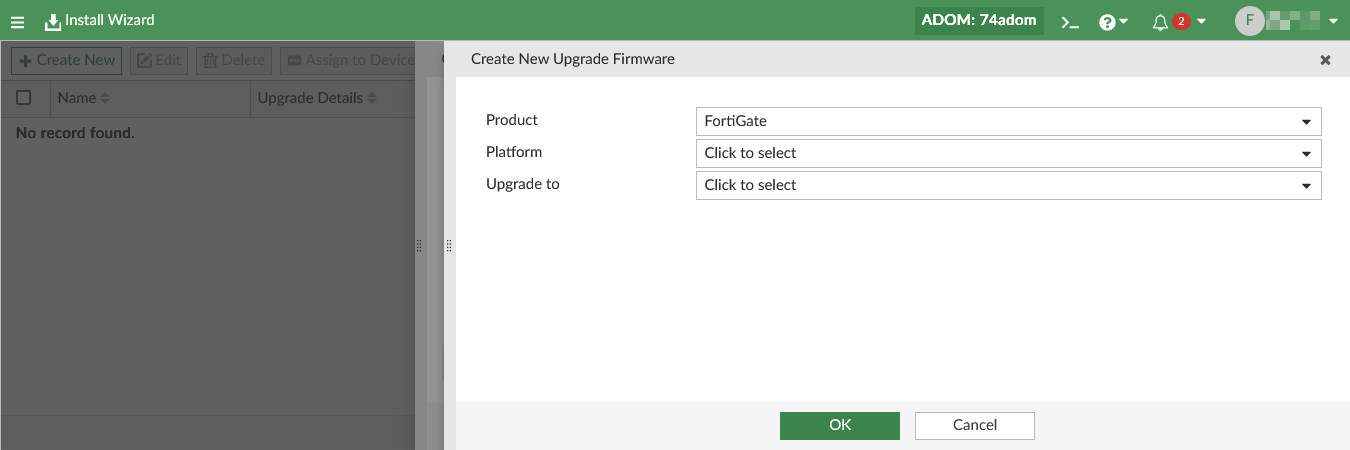

    1. In the Upgrade Details area, click Create New.
      The Create New Upgrade Firmware dialog box is displayed.
    2. In the Product dropdown, select a product to upgrade.
    3. In the Platform dropdown, select the platform for the product.
    4. In the Upgrade to dropdown, select the target firmware version for the upgrade.
    5. Click OK. The upgrade details are saved.
  5. In the Install Window area, you can schedule the upgrade:
    Schedule Type
    Specify whether to schedule the upgrade by selecting one of the following options:
    • None: Select to have no schedule. When a schedule is set to none, the upgrade will only occur when it is manually triggered by an administrator on demand. See Upgrading devices now.
    • Once: Select to schedule the upgrade to occur once.
    • Daily: Select to schedule the upgrade to occur daily.
    • Weekly: Select to schedule the upgrade to occur weekly.
    • On Board: Select to enforce the firmware version for managed fabric devices (FortiAP, FortiSwitch, or FortiExtender). Firmware version enforcement is performed whenever the device is online and its version does not match the template's. The chosen firmware version will be installed on the device even if the device is already on a later firmware version.
      Tooltip
      If the template remains assigned to the managing FortiGate, the firmware enforcement will trigger again any time the fabric device's firmware does not match the template's firmware and the device is online.
    Day
    Available when you select Weekly.
    Select what day of the week to run the upgrade.
    Start Time
    Available when you select Once, Daily, or Weekly.
    Specify what time to start the upgrade.
    End Time
    Specify what time to end the upgrade. If the upgrade is not completed by the end time, the upgrade stops.
  6. In the Upgrade Options area, set the following options:
    Boot from Alternate Partition After Upgrade
    Applies only to FortiGates.
    Select to upgrade the inactive partition. Clear to skip the inactive partition during upgrade.
    Selecting this option causes the device to reboot twice during the upgrade process: first to upgrade the inactive partition, and second to boot back into the active partition.
    Let Device Download Firmware from FortiGuard
    Select to have the device download the firmware from FortiGuard for the upgrade.
    Clear to have the device download the firmware from FortiManager.
    Upgrade Path
    Select one of the following options:
    • Skip All Intermediate Steps in Upgrade Path If Possible: Select to skip some builds in an upgrade path.
    • Follow The Recommended Upgrade Path: Select to install all builds in an upgrade path.
    Tooltip
    The Follow The Recommended Upgrade Path feature is not supported when FortiManager is operating in a closed network. Each image in the path must instead be imported to FortiManager and manually pushed to the managed devices in the correct order. You can view the recommended upgrade path at support.fortinet.com.
    Only upgrade FortiGate Clusters with all members up
    When enabled, if any HA secondary node is down, the firmware upgrade will be skipped for the HA cluster.
  7. Click OK. The upgrade template is created.
