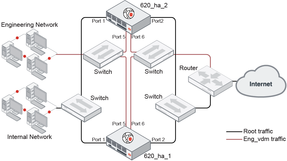

Example
This example shows a virtual cluster configuration consisting of two FortiProxies. The virtual cluster has two VDOMs, Root and End_vdm.
The root VDOM can only be associated with virtual cluster 1. |

- Make all the necessary connections as shown in the topology diagram.
