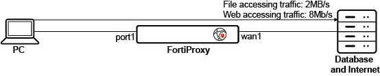

Traffic shaping is accomplished by configuring the outgoing bandwidth and outgoing shaping profile on an interface. The shaping profile uses the outgoing bandwidth of the interface as the maximum link speed, and it only works when the outgoing bandwidth is configured.
This example shows how to apply interface-based traffic shaping to web and file accessing traffic:
  • The link speed of the wan1 interface is 10 Mb/s.
  • File access can use up to 2 Mb/s.
  • Web access can use 8 Mb/s.

In this example, the link speed of the wan1 interface is 10 Mb/s.

  4. Configure a web accessing traffic shaping class:
    When other types of traffic are competing for bandwidth, this class is guaranteed to 6 Mb/s, or 60% of the bandwidth.
    1. In the Traffic Shaping Classes table click Create New.
    2. Configure the following settings, then click OK:
      Traffic shaping class ID
      Web Access
      Guaranteed bandwidth
      60
      Maximum bandwidth
      80
      Priority
      Medium
  5. Configure a file accessing traffic shaping class:
    When other types of traffic are competing for bandwidth, this group is guaranteed to 1 Mb/s, or 10% of the bandwidth.
      File Access
      10
      Maximum bandwidth
      20
      Priority
      Medium
  6. Click OK.

Defining the available bandwidth on an interface
To set the bandwidth of the wan1 interface in the GUI:
  1. Go to Network > Interfaces.
  2. Edit the wan1 interface.
  3. Under Traffic Shaping, enable Outbound shaping profile and select the profile that you just created, Day_Hours_Profile.
  4. Enable Outbound Bandwidth and set it to 10000 Kbps.
  5. Click OK.
To set the bandwidth of the wan1 interface in the CLI:
config system interface
    edit "wan1"
        set egress-shaping-profile "Day_Hours_Profile"
        set outbandwidth 10000
