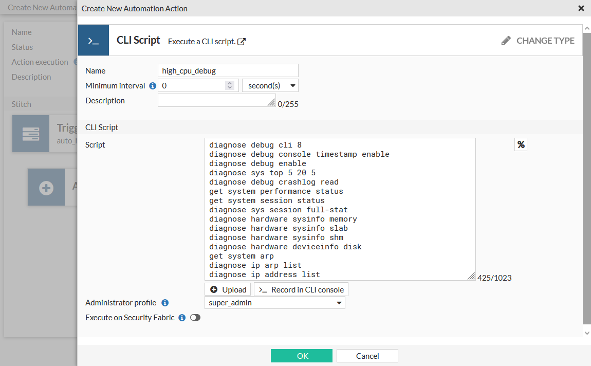

Configure the CLI Script action:
Click Add Action.
Click Create and select CLI Script.
Enter the following:
Name
high_cpu_debug
Script
diagnose debug cli 8 diagnose debug console timestamp enable diagnose debug enable diagnose sys top 5 20 5 diagnose debug crashlog read get system performance status get system session status diagnose sys session full-stat diagnose firewall iprope state diagnose sys flash list diagnose hardware sysinfo memory diagnose hardware sysinfo slab diagnose hardware sysinfo shm diagnose hardware deviceinfo disk get system arp diagnose ip arp list diagnose ip address list get router info routing-table all get router info kernel
Administrator profile
Select a profile
Click OK.
Select the action in the list and click Apply.
