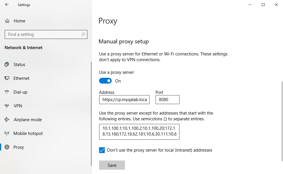

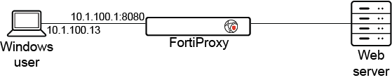

In this example, a Windows PC user configures an HTTPS URL (https://cp.myqalab.local) as the proxy address for the explicit web proxy. When the user opens a browser (such as Edge or Chrome), the browser will use the HTTPS URL to connect to the explicit web proxy and send any HTTP requests to the proxy over HTTPS. The certificate (server_cert) contains the explicit web proxy's name (cp.myqalab.local) as its CN, so the browser will accept this certificate for the TLS connection.
To configure the Windows proxy settings:
On the Windows PC, go to Settings > Network & Internet > Proxy.
In the Manual proxy setup section configure the following:
Enable Use a proxy server.
Set the Address to https://cp.myqalab.local.
Set the Port to 8080.
If needed, enter any addresses to exempt in the text box (use a semicolon to separate entries).
Enable Don't use the proxy server for local (intranet) addresses.
Click Save.

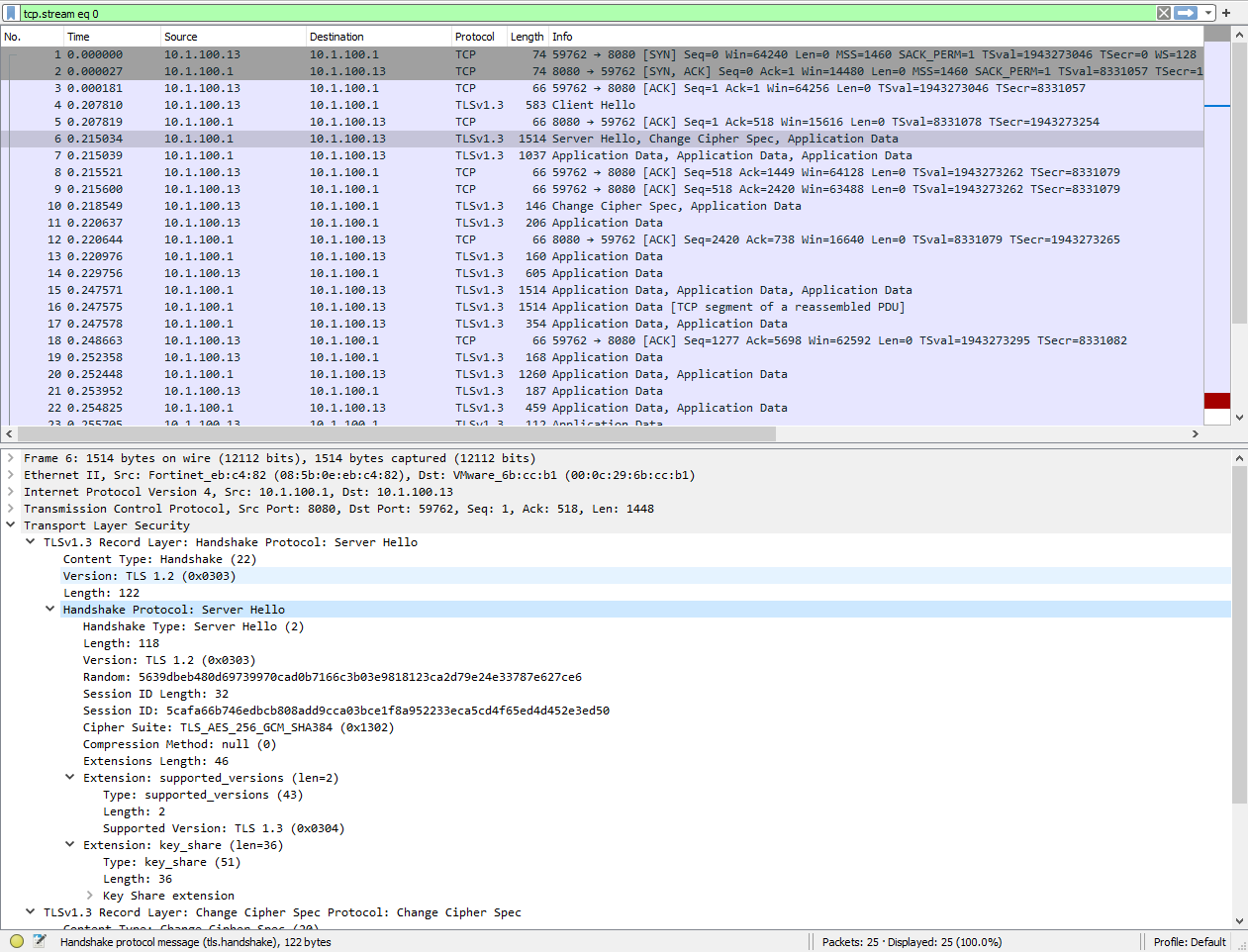

To verify the TLS connection:
Perform a packet capture of HTTPS traffic between the web client and the web server. Wireshark is used in this example.
Locate the exchange between the web client (10.1.100.13) and the explicit web proxy (10.1.100.1:8080):
After the client initiates the TLS connection to the explicit web proxy with a client hello packet, the web proxy is able to respond appropriately with a server hello packet to establish a TLS connection first before any HTTP messages are exchanged, and all HTTP messages will be protected by the TLS connection.
