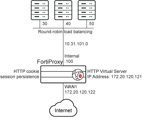

Sample topology

Sample of HTTP load balancing to three real web servers
This example describes the steps to configure the load balancing configuration below. In this configuration, a FortiProxy unit is load balancing HTTP traffic from the Internet to three HTTP servers on the internal network. HTTP sessions are accepted at the wan1 interface with destination IP address 172.20.120.121 on TCP port 8080, and forwarded from the internal interface to the web servers. When forwarded, the destination address of the session is translated to the IP address of one of the web servers.
This load balancing configuration also includes session persistence using HTTP cookies and round-robin load balancing for the real servers.

Traffic accessing 172.20.120.121:8080 is forwarded in turn to the three real servers.
If the access request has an http-cookie, FortiProxy forwards the access to the corresponding real server according to the cookie.
