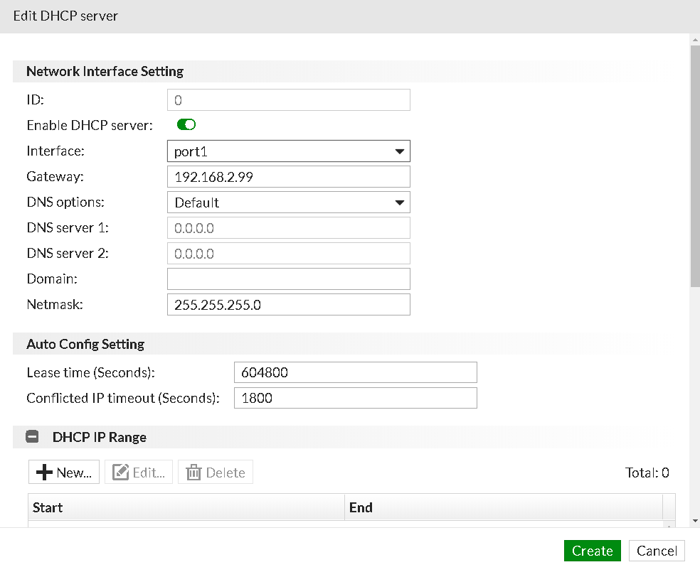

  5. Configure the built-in DHCP server:
    1. On the FortiRecorder GUI, go to System > Network > DHCP.
    2. Click New.
    3. Enable Enable DHCP server.
    4. From Interface, select port1.
    5. In the DHCP IP Range area, click New. Enter a range of IP addresses (pool) that is larger than all of the devices that you want to connect.
      DHCP IP addresses must be in the same subnet as the IP address that you will give to port1. For example, if port1 is 192.168.1.9/24, then a DHCP range for 10 cameras could be 192.168.1.10-192.168.1.19.
    6. Click the Create button to close the dialog, and then click the Create button to start the DHCP server.

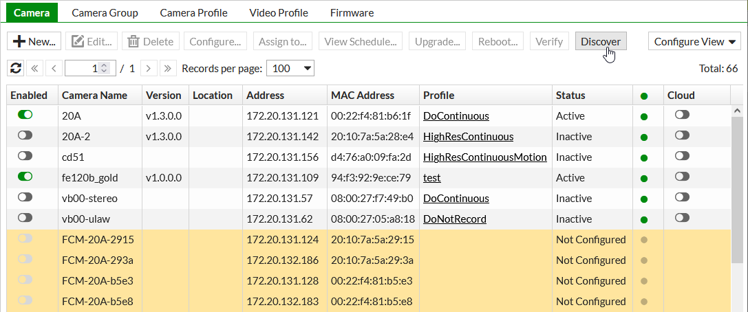

  8. Discover and configure the cameras:
    1. Go to Camera > Configuration > Camera.
    2. Click the Discoverbutton.
      After several seconds, a list of cameras appears. Newly discovered cameras are highlighted in yellow, and their Status column displays Not Configured.
    3. Double-click each camera to configure its settings. For details, see Configuring cameras.
      Repeat this step for all cameras.
