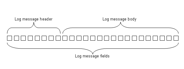

All FortiRecorder log messages have a timestamp and then key-value pair fields. Fields are organized into a header and a body.
fields in the log message header and body
  • Header — Located at the start of all log messages. Contains the event timestamp, a log identifier (log_id) , the type and subtype, and then the severity level (pri) of the event. Some fields (devid and log_part) vary by remote storage of logs, and by log message length.
  • Body — Located after the header fields. Contains the message (msg) field. Other body fields vary by type or subtype, such as the associated user name (if any), and actions (if any) that the FortiRecorder appliance took to respond to the event
For example, in the following log message, the fields in bold are the header. The remaining fields are the body.
2023-10-20 13:53:59.297 log_id=0801000001 type=kevent subtype=admin pri=information user=admin ui=ssh(172.20.130.28) action=login status=success reason=none msg="User admin logged in successfully from ssh(172.20.130.28)"
