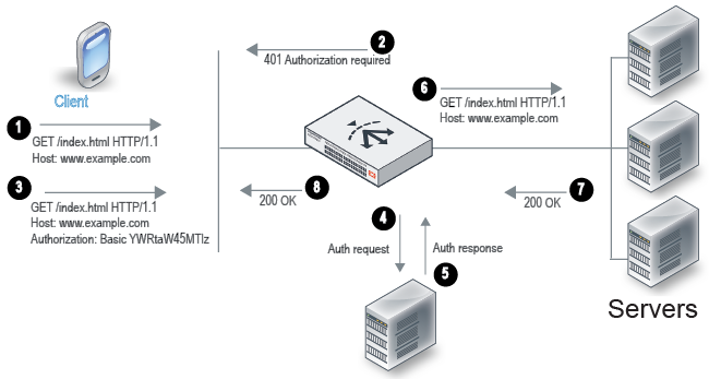

For example, you can define an auth policy for a standard authentication server type that has the following logic: if the Host header matches example.com and the URI matches /index.html, then the group example-group is authorized. FortiADC supports the Basic Authentication Scheme described in RFC 2617.
Figure 3 illustrates the client-server communication when authorization is required.
- The client sends an HTTP request for a URL belonging to a FortiADC virtual server that has an authorization policy.
- FortiADC replies with an HTTP 401 to require authorization. On the client computer, the user might be prompted with a dialog box to provide credentials.
- The client reply includes an Authorization header that gives the credentials.
- FortiADC sends a request to the server (local, LDAP, or RADIUS) to authenticate the user.
- The authentication server sends its response, which can be cached according to your user group configuration.
- If authentication is successful, FortiADC continues processing the traffic and forwards the request to the real server.
- The real server responds with an HTTP 200 OK.
- FortiADC processes the traffic and forwards the server response to the client.
