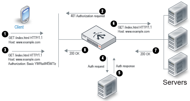

How Access Policies Work
Authorization and authentication illustrates the client-server communication when authorization is required.
An Access Policy consists of authentication conditions and an associated user group. When a client attempts to access a virtual server that requires authentication, the following process occurs:
  1. The client sends an HTTP request for a URL belonging to a FortiADC virtual server that has an authorization policy.
  2. FortiADC replies with an HTTP 401 to require authorization. On the client computer, the user might be prompted with a dialog box to provide credentials.
  3. The client reply includes an Authorization header that gives the credentials.
  4. FortiADC sends a request to the server (local, LDAP, or RADIUS) to authenticate the user.
  5. The authentication server sends its response, which can be cached according to your user group configuration.
  6. If authentication is successful, FortiADC continues processing the traffic and forwards the request to the real server.
  7. The real server responds with an HTTP 200 OK.
  8. FortiADC processes the traffic and forwards the server response to the client.
