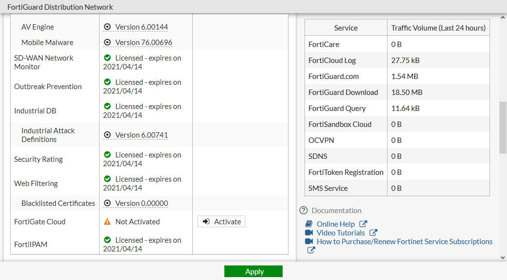

To verify the FortiIPAM service registration in the GUI:
  1. Go to System > FortiGuard to verify the FortiIPAM service is registered. If the service is registered, the FortiIPAM area at the bottom of the page displays a check mark as well as the license expiry date.

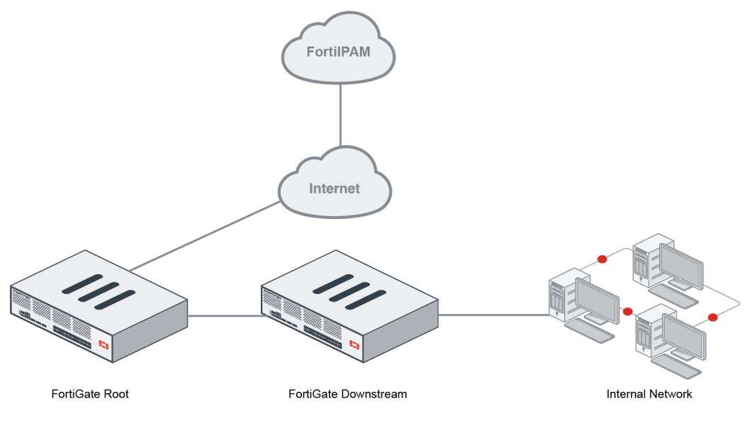

In this example, you will configure port5 on FortiGate Root to be managed by FortiIPAM and specify the network size. Next you will enable DHCP on the interface to supply IP addresses to this network.
Once FortiIPAM is designated as the IP source, you will configure the port5 interface on FortiGate Downstream to obtain an IP from DHCP to connect it to FortiGate Root and add it to the Security Fabric. Lastly, you will use FortiIPAM to assign IP addresses to the Internal Network.

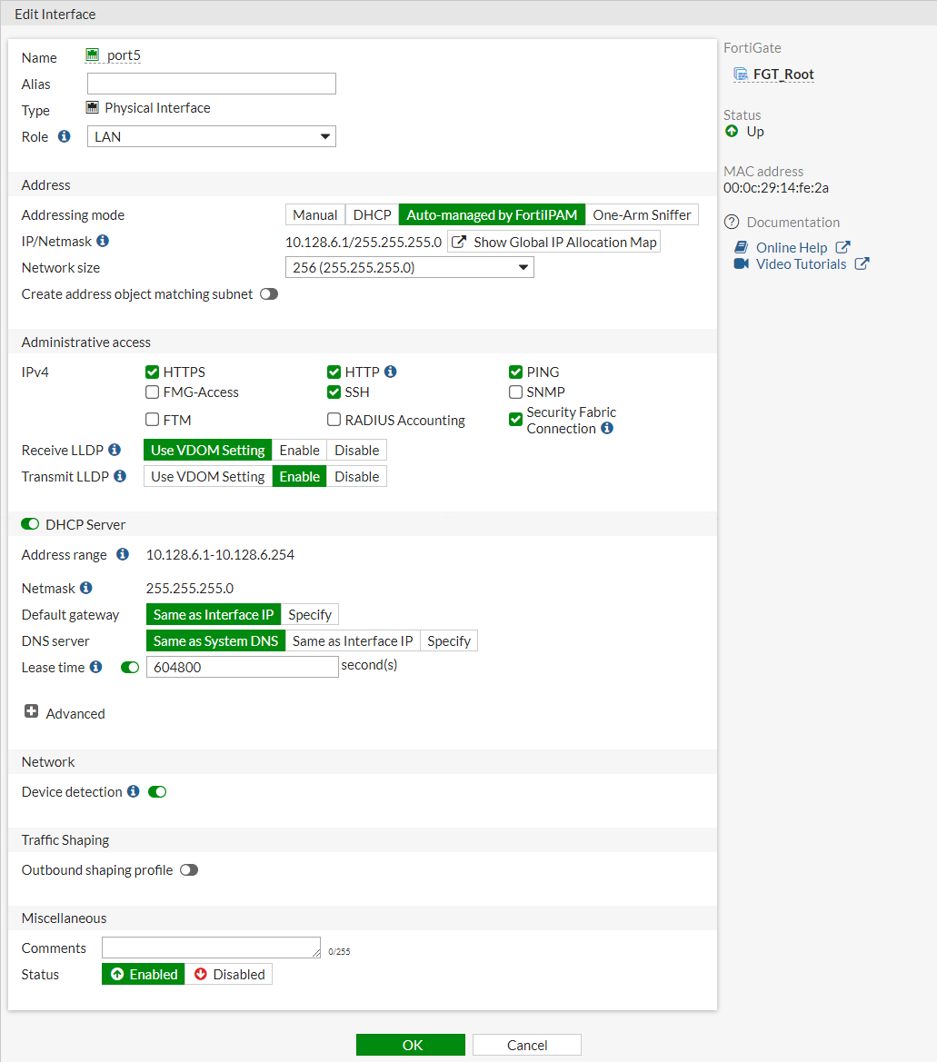

  1. On FortiGate Root, edit port5 and configure the interface to be managed by FortiIPAM.
    1. Go to Network > Interfaces, and double-click port5 to edit it. The Edit Interface window opens.

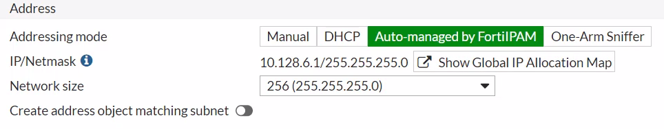

    2. From the Role dropdown, select LAN.
    3. In the Addressing mode area, select Auto-managed by FortiIPAM. An information icon appears next to IP/Netmask and below the Network Size dropdown indicating FortiIPAM will allocate an IP subnet with the selected size.
    4. From the Network Size dropdown, select the size of the network segment for this interface.
    5. Enable DHCP Server to allow the interface to supply IP addresses to this network.
      You do not need to configure Address range and Netmask. These will be configured by FortiIPAM.
    6. Click OK. Port5 gets an IP address from FortiIPAM corresponding to the network size. It will also start assigning addresses through DHCP. Refresh this page if an IP has not been assigned.

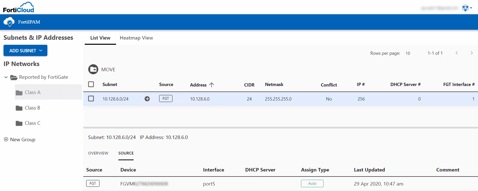

  2. View the IP allocation map.
    1. Go to Network > Interfaces, and double-click port5 to view it.
    2. In the IP/Netmask area, click Show Global IP Allocation Map. You are redirected to FortiCloud.
    3. Click Login. The FortiIPAM portal opens. The List View displays the assigned IP entries.
    4. Double-click an IP entry and click the Source tab. The IP source appears in the Device column. The Interface column displays the port. Assign Type displays Auto. Last Updated displays the assign time.

    1. Go to System > FortiGuard, and verify FortiIPAM is licensed.

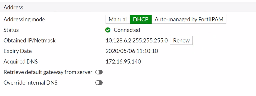

    2. Go to Network > Interfaces, and double click port5 to edit it.
    3. In the Addressing mode area, select DHCP and click OK. The interface will get its IP address from the DHCP server configured on FortiGate Root.
    4. In Network > Interfaces, double-click port5. The following fields appear in the Address area:
      • Status.
      • Obtained IP/Netmask
      • Expiry Date
      • Acquired DNS

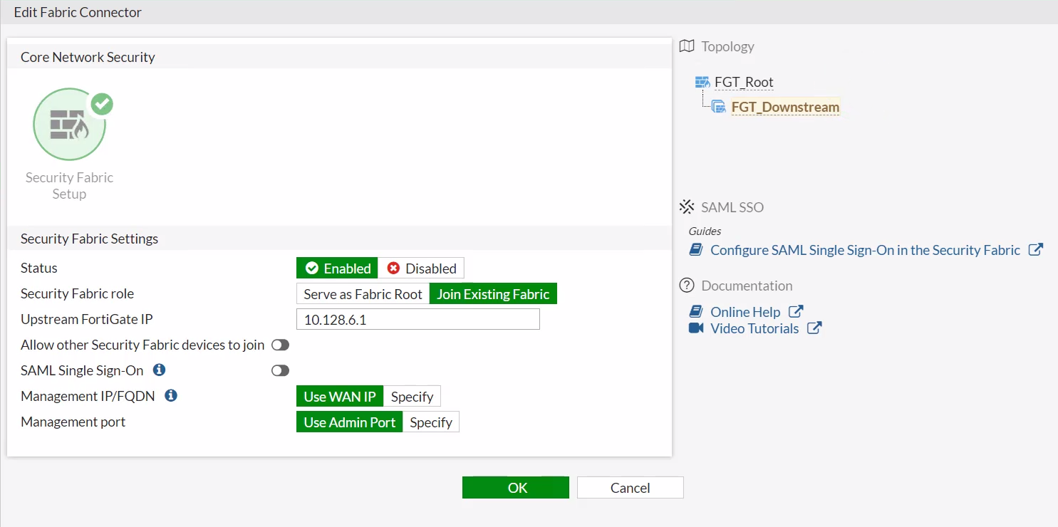

  5. Add FortiGate Downstream to the Security Fabric.
    1. Go to Security Fabric > Fabric Connectors. In the Security Fabric Settings area, set Status to Enabled.
    2. In the Upstream FortiGate IP field, enter the IP address for FortiGate Root, and click OK. The Topology pane shows the connection is established.

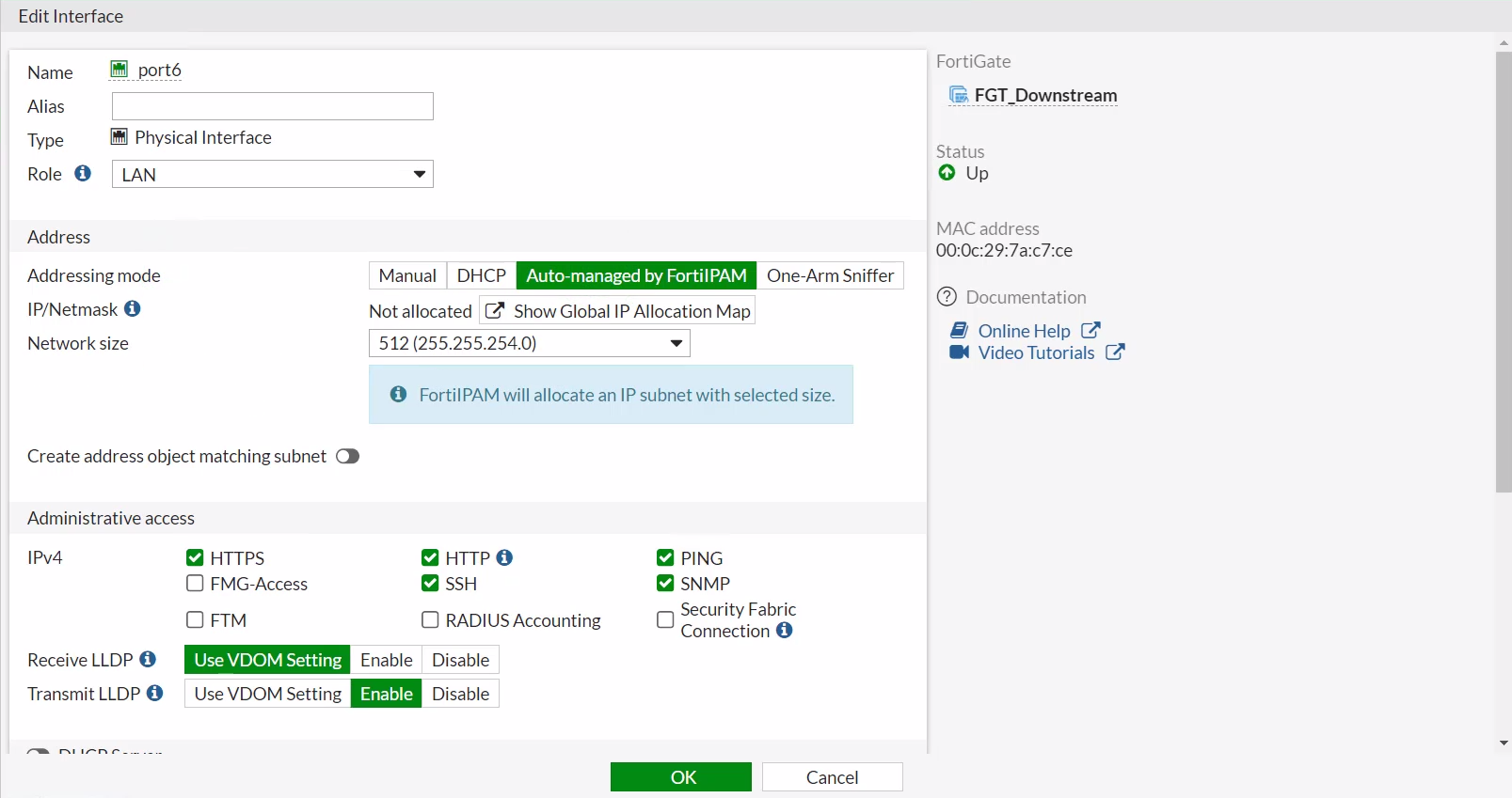

  6. On FortiGate Downstream, configure port6 to use FortiIPAM.
    1. Go to Network > Interfaces. Double-click port6 to edit it.
    3. In the Address mode area, select Auto-managed by FortiIPAM.
    4. From the Network size dropdown, select a different network size. In this example, the network size was increased to 512.
    5. Wait a while and then double-click port6. The IP/Netmask is auto-populated.
    6. Enable DHCP Server to allow the interface to supply IP addresses to this network.

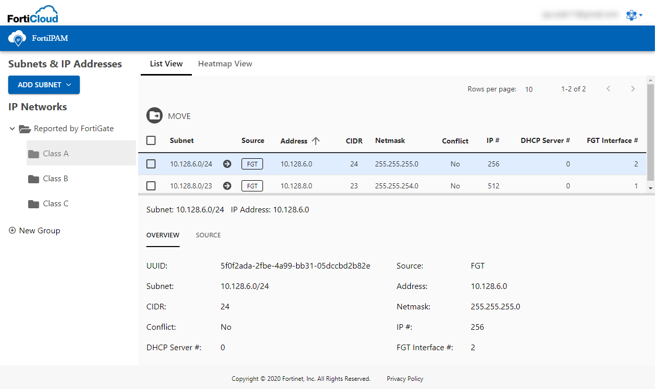

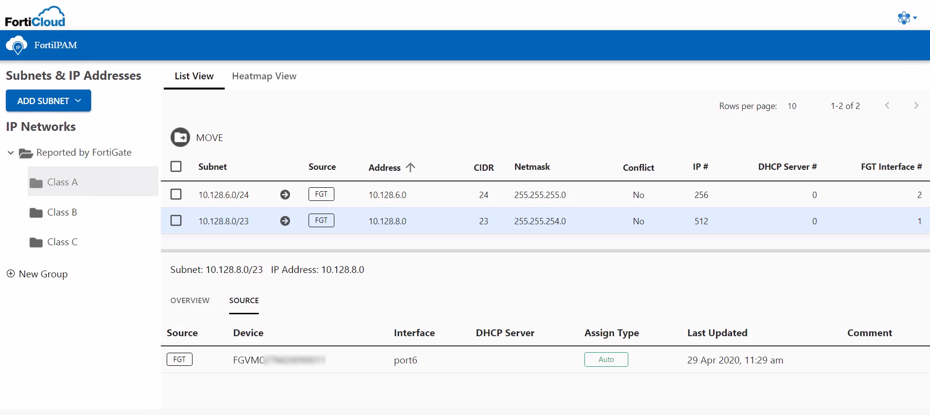

  7. Go back to the FortiIPAM portal in FortiCloud.
    1. The List View tab shows the IP addresses for the downstream FortiGates.
    2. Select a subnet, and click the Source tab. The source details show that the IP is different from the root FortiGate, preventing conflicts.

  4. On FortiGate Downstream, configure port5 to obtain an IP from DHCP.
    config system interface
    edit "port5"
    set mode dhcp
  5. After the IP is assigned and the device is connected to FortiGate Root , add FortiGate Downstream to the Security Fabric.
  6. Once FortiGate Downstream is connected to the Security Fabric, you can configure the port6 interface to use the FortiIPAM service as well.
  7. On FortiGate Downstream , set the interface to be managed by the FortiIPAM service, and increase the managed-subnetwork-size value.
    edit "port5"
    set ip-managed-by-fortiipam enable
    set managed-subnetwork-size 512

  9. Go to the FortiIPAM Portal to view the IP addresses.
