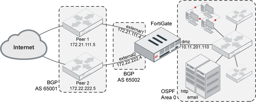

A company has its own web and email servers in an OSPF area, and needs to advertise routes to these resources to external peers. Users, routers, and other server all reside in the OSPF area.
The FortiGate acts as the BGP border router, redistributing routes from the company's network to its BGP peers. It is connected to the OSPF area using its DMZ interface.
Two ISP managed BGP peers in an AS (Peer 1 and Peer 2) are used to access the internet, and routes must not to be advertised from Peer 1 to Peer 2. The manufacturers of these routers, and information about other devices on the external BGP AS, are not known.
Routes to the BGP peers are redistributed so that external locations can access the web and email servers in the OSPF area. The FortiGate device's external interfaces and the BGP peers are in different ASs, and form eBGP peers.
