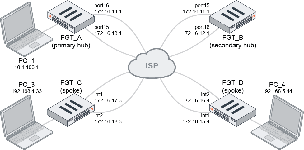

The following example uses a dual hub and spoke topology. Each hub and spoke has two WAN link connections to the ISP. The spokes generate two IPsec tunnels to each hub (four tunnels in total). BGP neighbors are established over each tunnel and routes from the hubs and other spokes learned from all neighbors, which forms an ECMP scenario. All tunnels are placed as SD-WAN members, so traffic can be distributed across tunnels based on the configured SD-WAN service rules.

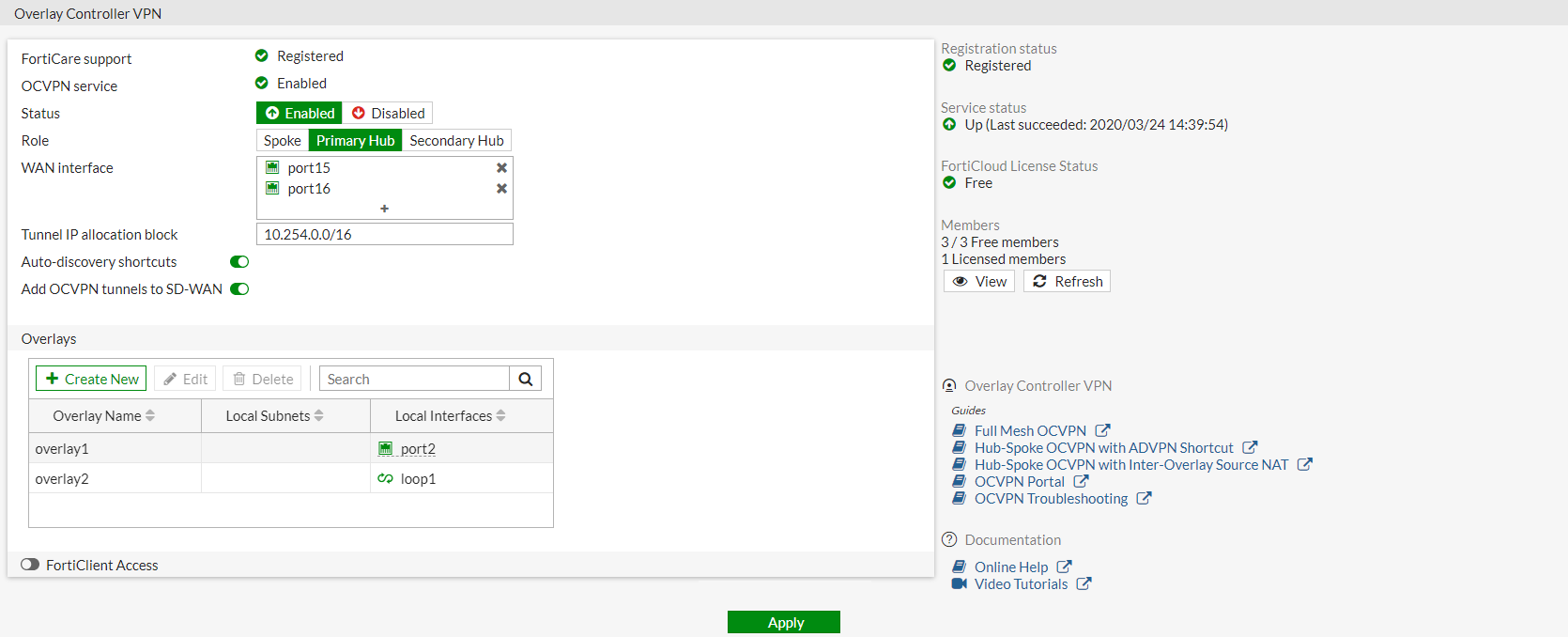

- Configure the primary hub:
- Go to VPN > Overlay Controller VPN and set the Status to Enable.
- For Role, select Primary Hub.
- Enter the WAN interfaces (port15 and port16) and tunnel IP allocation block (10.254.0.0/16).
The WAN interface is position sensitive, meaning a tunnel will be created with the first position interface on the hub to the first position interface on the spoke, and so on. In this example, FGT_A (primary hub) will create two tunnels with FGT_C (spoke):
- FGT_A port15 <==> FGT_C internal1
- FGT_A port16 <==> FGT_C internal2
- Enable Auto-discovery shortcuts.
- Enable Add OCVPN tunnels to SD-WAN. The IPsec tunnels will be added automatically to the SD-WAN members if SD-WAN is enabled.
- Configure the overlays on the primary hub:
- In the Overlays section, click Create New.
- Enter a name and add the local interface (port2). Note the overlay is either based on local subnets or local interfaces, but not both.
By default, inter-overlay traffic is not enabled. Toggle Allow traffic from other overlays to enable it.
- Click OK and repeat these steps to create the second overlay (loop1).
- Click Apply.

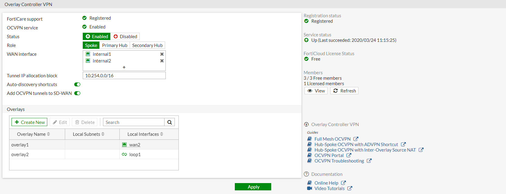

- Configure the spoke:
- For Role, select Spoke.
- Enter the WAN interfaces (internal1 and internal2).
- Configure the overlays.
The overlay names on the spokes must match the hub for the traffic to be allowed through the same overlay.
- Click Apply.

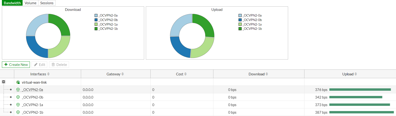

- On a spoke, go to Network > SD-WAN Zones to view the configuration generated by OCVPN.

- Configure SD-WAN:
config system sdwan set status enable config members edit 1 set interface "_OCVPN2-0a" next edit 2 set interface "_OCVPN2-0b" next edit 3 set interface "_OCVPN2-1a" next edit 4 set interface "_OCVPN2-1b" next end endFirewall policies will be automatically generated by OCVPN between the local interfaces and the SD-WAN interface. Each policy will define the proper local and remote networks for its source and destination addresses.
