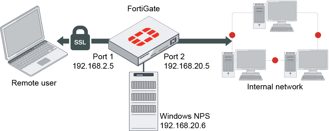

The user is connecting from their PC to the FortiGate's port1 interface. RADIUS authentication occurs between the FortiGate and the Windows NPS, and the SSL-VPN connection is established once the authentication is successful.

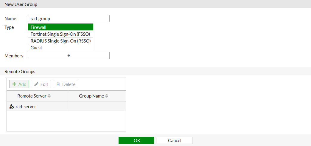

To configure a user group:
Go to User & Authentication > User Groups and click Create New.
Set Name to rad-group.
Under Remote Groups, click Add and add the rad-server.
Click OK.

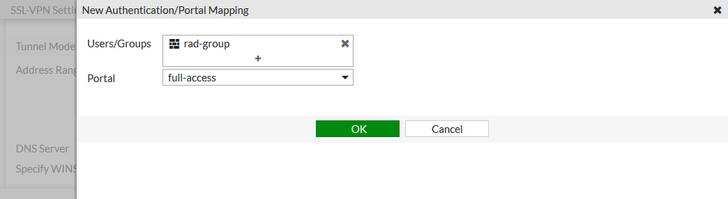

Under Authentication/Portal Mapping:
Edit All Other Users/Groups and set Portal to web-access.
Click Create New and create a mapping for the rad-group user group with Portal set to full-access.
Click OK.

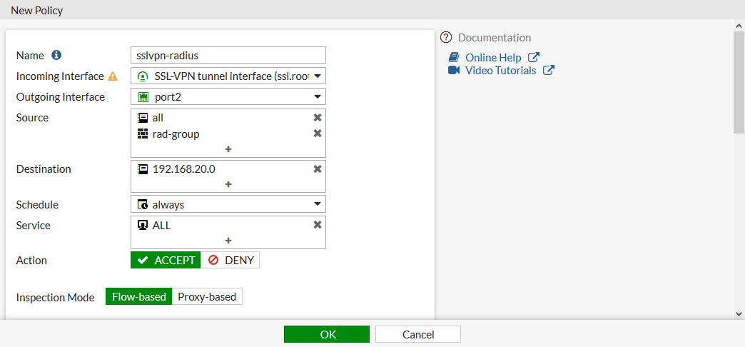

To configure an SSL VPN firewall policy:
Go to Policy & Objects > Firewall Policy and click Create New.
Set the policy name, in this example, sslvpn-radius.
Set Incoming Interface to SSL-VPN tunnel interface(ssl.root).
Set Outgoing Interface to the local network interface so that the remote user can access the internal network. In this example, port2.
Set the Source > Address to all and Source > User to rad-group.
Set Destination > Address to the internal protected subnet 192.168.20.0.
Set Schedule to always, Service to ALL, and Action to Accept.
Enable NAT.
Configure the remaining options as required.
Click OK.
