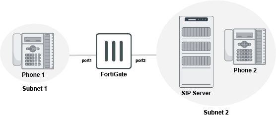

Example
In this example, Phone1 is in subnet_1, and the SIP server and phone are in subnet_2. All SIP signaling messages and RTP/RTCP packets go through the SIP Server. The RTP/RTCP ports on Phone1 are configured as 17078/17079.
The FortiGate administrator wants to use NAT for the port 17078/17079 to 30000/30001. As a result, all RTP/RTCP packets going out of port2 have source ports of 30000/30001, and all RTP/RTCP packets going into port2 also have destination ports of 30000/30001, which is specified in nat-port-range.

If phone1 and phone2 are registered to the SIP server, and they establish a call session between them through the FortiGate and the SIP server, then the RTP/RTCP ports 17078/17079 of phone1 will be translated to ports 30000/30001 at the FortiGate unit based on the NAT port range setting. That is, the RTP/RTCP packets egressing port2 of the Fortigate will have source ports of 30000/30001, and the RTP/RTCP packets ingressing port2 will have destination ports of 30000/30001.
