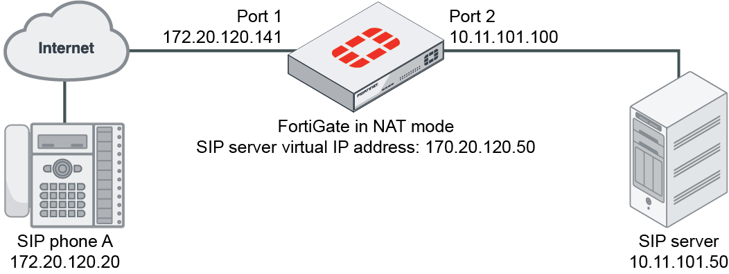

VIP
A FortiGate with SIP Application Layer Gateway (ALG) or SIP Session Helper protects the SIP server from the internet, while SIP phones from the internet need to register to the SIP server and establish calls through it.
A VIP needs to be configured for the SIP server, and the VIP must be applied in a firewall policy for the phones to send REGISTER messages through the FortiGate from port1 to port2.
Only one firewall policy needs to be configured for all SIP phones on both the internet and private network to register to the SIP server through Port1 and set up SIP calls.
Assuming either SIP ALG or SIP Session Helper is enabled, configure the FortiGate with the following CLI commands:
config firewall vip
edit "VIP_for_SIP_Server"
set extip 172.20.120.50
set extintf "port1"
set mappedip "10.11.101.50"
config firewall policy
set srcintf "port1"
set dstintf "port2"
set srcaddr "all"
set dstaddr "VIP_for_SIP_Server"
set service "SIP"
Setting |

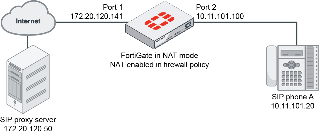

NAT
A FortiGate with SIP ALG or SIP Session Helper protects the SIP phones and the internal network from the internet, while SIP phones in the internal network need to register to the SIP server installed on the internet and establish calls through it.
One firewall policy needs to be configured with NAT enabled for SIP phones to send REGISTER messages through the FortiGate from port2 to port1.
set srcintf "port2"
set dstintf "port1"
set srcaddr "all"
set dstaddr "all"
set service "SIP"
set nat enable

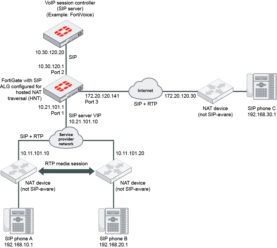

HNT
A FortiGate with SIP ALG or SIP Session Helper protects the SIP server from the internet, while SIP phones are in remote private networks behind NAT devices that are not aware of the SIP application.
For example, the SIP server is located in an ISP's service cloud that is protected by the FortiGate SIP ALG, and the SIP phones are installed in the home networks of the ISP's customers.
The SIP messages traversing the remote NAT devices might have their IP addresses translated by the NAT device at the network layer, but untranslated at the SIP application layer because those NAT devices are not aware of the SIP applications. This causes problems in a SIP session initiated process. Special configurations for the Hosted NAT Traversal (HNT) are required to resolve this issue.
To configure the FortiGate with HNT support for SIP phones A and B to set up calls with each other:
- Identify port1 as the external interface:
config system interface edit "port1" set external enable next end - Configure VIP for the SIP server:
config firewall vip edit "VIP_for_SIP_Server" set extip 10.21.101.10 set extintf "port1" set mappedip "10.30.120.20" next end - Configure a VoIP profile with HNT enabled:
config voip profile edit "hnt" config sip set hosted-nat-traversal enable set hnt-restrict-source-ip enable end next end
hosted-nat-traversalmust be enabled.hnt-restrict-source-ipdoes not have to be enabled, but can be enabled to restrict the RTP packets’ source IP to be the same as the SIP packets’ source IP. - Apply the VoIP profile and VIP in a firewall policy for phone A and B to register and set up SIP calls through the FortiGate and SIP server:
config firewall policy edit 1 set srcintf "port1" set dstintf "port2" set srcaddr "all" set dstaddr "VIP_for_SIP_Server" set action accept set schedule "always" set service "SIP" set utm-status enable set voip-profile “hnt” set nat enable next end
natmust be enabled in the firewall policy.
