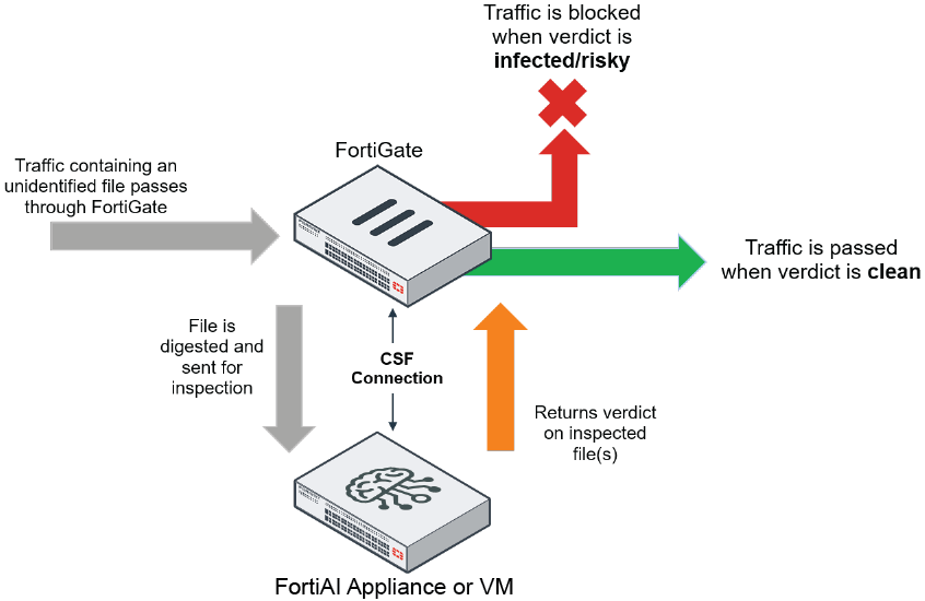

FortiAI can be used with antivirus profiles in proxy inspection mode (flow mode is currently not supported). FortiAI inspects high-risk files and issues a verdict to the firewall based on how close the file features match those of malware. When enabled, FortiAI can log, block, ignore, or monitor (allow) the file based on the verdict.
A licensed FortiAI appliance with version 1.5.1 or later is required to use this feature. |

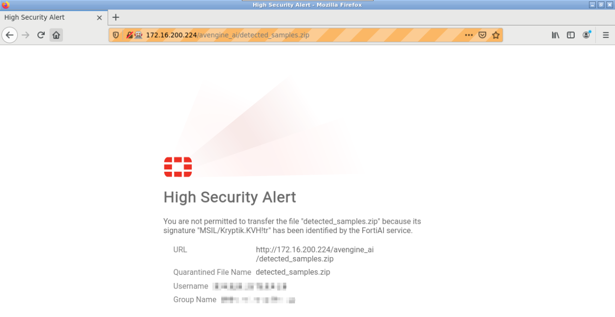

config antivirus profile edit "av" set feature-set proxy config http set fortiai block end config ftp set fortiai block end config imap set fortiai block end config pop3 set fortiai block end config smtp set fortiai block end config mapi set fortiai block end config nntp set fortiai block end config cifs set fortiai block end config ssh set fortiai block end next end - Add the AV profile to a firewall policy. When potential infections are blocked by FortiAI inline inspection, a replacement message appears (FortiAI Block Page, see Replacement messages for more information). An infection blocked over HTTP looks similar to the following:
Sample log
date=2021-04-29 time=15:12:07 eventtime=1619734327633022960 tz="-0700" logid="0209008221" type="utm" subtype="virus" eventtype="fortiai" level="notice" vd="vdom1" policyid=1 msg="Detected by FortiAI." action="monitored" service="HTTP" sessionid=13312 srcip=10.1.100.221 dstip=172.16.200.224 srcport=50792 dstport=80 srcintf="wan2" srcintfrole="wan" dstintf="wan1" dstintfrole="wan" proto=6 direction="incoming" filename="detected_samples.zip" quarskip="File-was-not-quarantined" virus="MSIL/Kryptik.KVH!tr" dtype="FortiAI" ref="http://www.fortinet.com/ve?vn=MSIL%2FKryptik.KVH%21tr" virusid=0 url="http://172.16.200.224/avengine_ai/detected_samples.zip" profile="av" agent="curl/7.68.0" analyticssubmit="false" crscore=50 craction=2 crlevel="critical"
