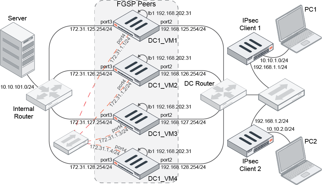

In this example, the FGSP peers are connected on port4 over 172.31.1.1-4/24. Each peer has a loopback interface, lb1, with the same IP address. This loopback interface is used as the local gateway on each of the phase 1 connections to avoid each FGSP member having different IPs on port2. The DC Router uses ECMP to distribute traffic to each FGSP peer. It is assumed that the networking addresses are already configured properly.

Out of the four FGSP peers, DC1_VM1, DC1_VM2, and DC1_VM3 have fgsp-sync enabled in their IPsec phase 1 configurations. This allows the three FGSP members to synchronize IPsec SAs as clients establish dialup tunnels to them individually. DC1_VM4, which does not have fgsp-sync configured, will not participate in synchronizing IPsec SAs or establishing tunnels. The DC Router uses ECMP to route traffic to the destination 192.168.202.31 through each of the participating FGSP peers.
In a larger scale there may be many more IPsec dialup clients connecting, with each eligible FGSP peer being the primary gateway for a set of dialup tunnels, and is in standby for the rest of the tunnels. If an FGSP peer fails, traffic will fail over to other peers, and these peers will become primary gateways for the respective dialup tunnels.

  4. Configure the VPN tunnel phase 2 settings:
        edit "vpn1"
            set phase1name "vpn1"
            set proposal aes128-sha1
            set keylifeseconds 10800
To verify the configuration:

  2. Initiate a dialup tunnel connection from the IPsec Client 2 FortiGate (192.168.1.2).
  3. Verify the tunnel list for vpn1_1 on each peer. The output shows the bi-directional SAs for that particular tunnel are synchronized to all participating FGSP peers.

    The IPsec tunnel role=sync-primaryon DC1_VM1 indicates that the IPsec tunnel was established on the FortiGate and traffic is being forwarded. On DC1_VM2 and DC1_VM3, the IPsec tunnel role=standby indicates that they are synchronized from the FGSP peer and are in standby for traffic forwarding.
    The IPsec SAs do not synchronize to DC1_VM4 because fgsp-sync is disabled.
  4. When a failure occurs on DC1_VM1, the tunnel traffic will fail over to either DC1_VM2 or DC1_VM3. Its tunnel role will become role=sync-primary.
