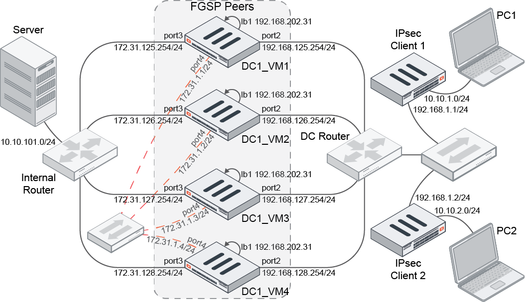

Example
In this example, the FGSP peers are connected on port4 over 172.31.1.1-4/24. Each peer has a loopback interface, lb1, with the same IP address. This loopback interface is used as the local gateway on each of the phase 1 connections to avoid each FGSP member having different IPs on port2. The DC Router uses ECMP to distribute traffic to each FGSP peer. It is assumed that the networking addresses are already configured properly.

Out of the four FGSP peers, DC1_VM1, DC1_VM2, and DC1_VM3 have fgsp-sync
enabled in their IPsec phase 1 configurations. This allows the three FGSP members to synchronize IPsec SAs as clients establish dialup tunnels to them individually. DC1_VM4, which does not have fgsp-sync
configured, will not participate in synchronizing IPsec SAs or establishing tunnels. The DC Router uses ECMP to route traffic to the destination 192.168.202.31 through each of the participating FGSP peers.
