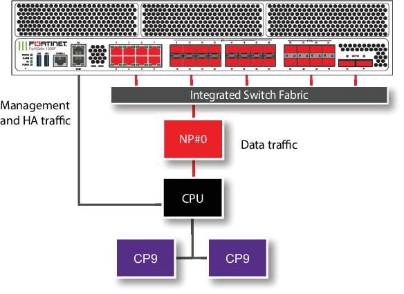

FortiGate 1000F and 1001F fast path architecture
The FortiGate 1000F and 1001F each include one NP7 processor. All front panel data interfaces and the NP7 processor connect to the integrated switch fabric (ISF). All data traffic passes from the data interfaces through the ISF to the NP7 processor. All supported traffic passing between any two data interfaces can be offloaded by the NP7 processor. Data traffic processed by the CPU takes a dedicated data path through the ISF and the NP7 processor to the CPU.
The FortiGate 1000F and 1001F models feature the following front panel interfaces:
  • One 10/100/1000/2.5GBASE-T RJ45 (HA) not connected to the NP7 processor.
  • One 10/100/1000BASE-T RJ45 (MGMT) not connected to the NP7 processor.
  • Eight 10G/5G/2.5G/1G/100M BASE-T RJ45 (1 to 8).
  • Sixteen 10/1 GigE SFP+/SFP (9 to 24).
  • Eight 25/10/1 GigE SFP28/SFP+/SFP (25 to 32), interface groups: 25 - 28, 29 - 32. Every time you change the speed of one of these interfaces from 25Gbps to 10Gbps or 1Gbps or from 10Gbps or 1Gbps to 25Gbps the speeds of the other interfaces in the group also change to that speed. When you enter the end command, the CLI confirms the range of interfaces affected by the change.
  • Two 100/40 GigE QSFP28/QSFP+ (33 and 34). Both of these interfaces can be split into four 25/10/1 GigE SFP28 interfaces.
The MGMT interface is not connected to the NP7 processor. Management traffic passes to the CPU over a dedicated management path that is separate from the data path. You can also dedicate separate CPU resources for management traffic to further isolate management processing from data processing (see Improving GUI and CLI responsiveness (dedicated management CPU)).
The HA interface is also not connected to the NP7 processor. To help provide better HA stability and resiliency, HA traffic uses a dedicated physical control path that provides HA control traffic separation from data traffic processing.
The separation of management and HA traffic from data traffic keeps management and HA traffic from affecting the stability and performance of data traffic processing.

By default, the speed of each split interface is set to 10000full (10GigE). These interfaces can operate as 25GigE, 10GigE, or 1GigE interfaces depending on the transceivers and breakout cables. You can use the config system interface command to change the speeds of the split interfaces.
If you set the speed of one of the split interfaces to 25000full (25GigE), all of the interfaces are changed to operate at this speed (no restart required). If the split interfaces are set to 25000full and you change the speed of one of them to 10000full (10GigE) they are all changed to 10000full (no restart required). When the interfaces are operating at 10000full, you can change the speeds of individual interfaces to operate at 1000full (1GigE).
Configuring NPU port mapping
You can use the following command to configure FortiGate-1000F and 1001F NPU port mapping:
config system npu
config port-npu-map
edit <interface-name>
set npu-group-index <index>
You can use the port map to assign data interfaces to NP7 links.
Each NP7 has two 100-Gigabit KR links, numbered 0 and 1. Traffic passes to the NP7 over these links. By default the two links operate as a LAG that distributes sessions to the NP7 processor. You can configure the NPU port map to assign interfaces to use one or the other of the NP7 links instead of sending sessions over the LAG.
<index> varies depending on the NP7 processors available in your FortiGate.
For the FortiGate-1000F <index> can be 0, 1, or 2:
  • 0, assign the interface to NP#0, the default, the interface is connected to the LAG. Traffic from the interface is distributed to both links.
  • 1, assign the interface to NP#0-link0, to connect the interface to NP7 link 0. Traffic from the interface is set to link 0.
  • 2, assign the interface to NP#0-link1, to connect the interface to NP7 link 1. Traffic from the interface is set to link 1.
For example, use the following syntax to assign FortiGate-1000F front panel 40 Gigabit interface 33 to NP#0- link0 and interface 34 to NP#0-link1. The resulting configuration splits traffic from the 40Gigabit interfaces between the two NP7 links:
config system npu
config port-npu-map
edit port33
set npu-group-index 1
edit port34
set npu-group-index 2
You can use the diagnose npu np7 port-list command to see the current NPU port map configuration. While the FortiGate-1000F or 1001F is processing traffic, you can use the diagnose npu np7 cgmac-stats <npu-id> command to show how traffic is distributed to the NP7 links.
For example, after making the changes described in the example, the np_group column of the diagnose npu np7 port-list command output for port33 and port34 shows the new mapping:
Front Panel Port:
Name     Max_speed(Mbps) Dflt_speed(Mbps) NP_group        Switch_id SW_port_id SW_port_name
port33   100000          100000           NP#0-link0      0         12
port34   100000          100000           NP#0-link1      0         8
