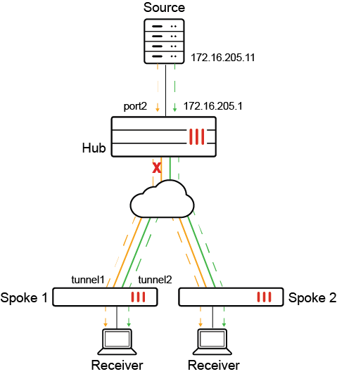

Example 1
In this hub and spoke example, the PIM source is behind the hub FortiGate, and the RP is set to internal port (port2) of the hub firewall. Each spoke connects to the two WAN interfaces on the hub by using an overlay tunnel. The overlay tunnels are members of SD-WAN.
Receivers behind the spoke FortiGates request a stream from the source to receive traffic on tunnel1 by default. When the overlay tunnel goes out of SLA, the multicast traffic fails over to tunnel2 and continues to flow.
Following is an overview of how to configure the topology:
- Configure the hub FortiGate in front of the PIM source. The RP is configured on internal port (port2) of the hub FortiGate.
- Configure the spoke FortiGates.
- Verify traffic failover.

To verify traffic failover:
With this configuration, multicast traffic starts on tunnel1. When tunnel1 becomes out of SLA, traffic switches to tunnel2. When tunnel1 is in SLA again, the traffic switches back to tunnel1.
The following health-check capture on the spokes shows tunnel1 in SLA with packet-loss (1.000%):
# diagnose sys sdwan health-check Health Check(ping): Seq(1 tunnel1): state(alive), packet-loss(0.000%) latency(0.056), jitter(0.002), mos(4.404), bandwidth-up(999999), bandwidth-dw(1000000), bandwidth-bi(1999999) sla_map=0x1 Seq(2 tunnel2): state(alive), packet-loss(0.000%) latency(0.100), jitter(0.002), mos(4.404), bandwidth-up(0), bandwidth-dw(0), bandwidth-bi(0) sla_map=0x1 # diagnose sys sdwan health-check Health Check(ping): Seq(1 tunnel1): state(alive), packet-loss(1.000%) latency(0.056), jitter(0.002), mos(4.404), bandwidth-up(999999), bandwidth-dw(1000000), bandwidth-bi(1999999) sla_map=0x1 Seq(2 tunnel2): state(alive), packet-loss(0.000%) latency(0.100), jitter(0.002), mos(4.404), bandwidth-up(0), bandwidth-dw(0), bandwidth-bi(0) sla_map=0x1
The following example shows tunnel1 out of SLA with packet-loss (3.000%):
# diagnose sys sdwan health-check Health Check(ping): Seq(1 tunnel1): state(alive), packet-loss(3.000%) latency(0.057), jitter(0.003), mos(4.403), bandwidth-up(999999), bandwidth-dw(1000000), bandwidth-bi(1999999) sla_map=0x0 Seq(2 tunnel2): state(alive), packet-loss(0.000%) latency(0.101), jitter(0.002), mos(4.404), bandwidth-up(0), bandwidth-dw(0), bandwidth-bi(0) sla_map=0x1
The following example shows tunnel1 back in SLA again:
# diagnose sys sdwan health-check Health Check(ping): Seq(1 tunnel1): state(alive), packet-loss(1.000%) latency(0.061), jitter(0.004), mos(4.404), bandwidth-up(999999), bandwidth-dw(1000000), bandwidth-bi(1999999) sla_map=0x0 Seq(2 tunnel2): state(alive), packet-loss(0.000%) latency(0.102), jitter(0.002), mos(4.404), bandwidth-up(0), bandwidth-dw(0), bandwidth-bi(0) sla_map=0x1 # diagnose sys sdwan health-check Health Check(ping): Seq(1 tunnel1): state(alive), packet-loss(0.000%) latency(0.061), jitter(0.004), mos(4.404), bandwidth-up(999999), bandwidth-dw(1000000), bandwidth-bi(1999999) sla_map=0x0 Seq(2 tunnel2): state(alive), packet-loss(0.000%) latency(0.102), jitter(0.002), mos(4.404), bandwidth-up(0), bandwidth-dw(0), bandwidth-bi(0) sla_map=0x1
The following example how traffic switches to tunnel2 while tunnel1 health-check is out of SLA. Source (172.16.205.11) sends traffic to the multicast group. Later the traffic switches back to tunnel1 once SLA returns to normal:
195.060797 tunnel1 in 172.16.205.11 -> 225.1.1.1: icmp: echo request 195.060805 port4 out 172.16.205.11 -> 225.1.1.1: icmp: echo request 196.060744 tunnel1 in 172.16.205.11 -> 225.1.1.1: icmp: echo request 196.060752 port4 out 172.16.205.11 -> 225.1.1.1: icmp: echo request 197.060728 tunnel1 in 172.16.205.11 -> 225.1.1.1: icmp: echo request 197.060740 port4 out 172.16.205.11 -> 225.1.1.1: icmp: echo request 198.060720 tunnel2 in 172.16.205.11 -> 225.1.1.1: icmp: echo request 198.060736 port4 out 172.16.205.11 -> 225.1.1.1: icmp: echo request 199.060647 tunnel2 in 172.16.205.11 -> 225.1.1.1: icmp: echo request 199.060655 port4 out 172.16.205.11 -> 225.1.1.1: icmp: echo request 200.060598 tunnel2 in 172.16.205.11 -> 225.1.1.1: icmp: echo request 200.060604 port4 out 172.16.205.11 -> 225.1.1.1: icmp: echo request ... ... ... ... 264.060974 port4 out 172.16.205.11 -> 225.1.1.1: icmp: echo request 265.060950 tunnel2 in 172.16.205.11 -> 225.1.1.1: icmp: echo request 265.060958 port4 out 172.16.205.11 -> 225.1.1.1: icmp: echo request 266.060867 tunnel2 in 172.16.205.11 -> 225.1.1.1: icmp: echo request 266.060877 port4 out 172.16.205.11 -> 225.1.1.1: icmp: echo request 267.060828 tunnel2 in 172.16.205.11 -> 225.1.1.1: icmp: echo request 267.060835 port4 out 172.16.205.11 -> 225.1.1.1: icmp: echo request 268.060836 tunnel1 in 172.16.205.11 -> 225.1.1.1: icmp: echo request 268.060854 port4 out 172.16.205.11 -> 225.1.1.1: icmp: echo request 269.060757 tunnel1 in 172.16.205.11 -> 225.1.1.1: icmp: echo request 269.060767 port4 out 172.16.205.11 -> 225.1.1.1: icmp: echo request 270.060645 tunnel1 in 172.16.205.11 -> 225.1.1.1: icmp: echo request 270.060653 port4 out 172.16.205.11 -> 225.1.1.1: icmp: echo request

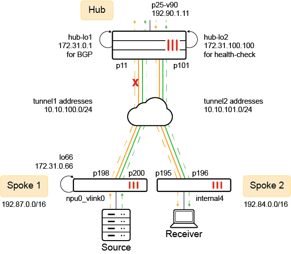

Example 2
In this hub and spoke example, the PIM source is behind spoke 1, and the RP is configured on the hub FortiGate. BGP is used for routing. The hub uses embedded SLA in ICMP probes to determine the health of each tunnel, allowing it to prioritize healthy IKE routes.
The receiver is on another spoke. Upon requesting a stream, source passes the traffic to the RP on the hub FortiGate, and routes the traffic to the receiver over tunnel1. If a tunnel falls out of SLA, the multicast traffic fails over to the other tunnel.
In this configuration, SD-WAN steers multicast traffic by using embedded SLA information in ICMP probes. See also Embedded SD-WAN SLA information in ICMP probes. With this feature, the hub FortiGate can use the SLA information of the spoke's health-check to control BGP and IKE routes over tunnels.
- Configure the hub FortiGate. The RP is configured on the hub FortiGate.
- Configure the spoke FortiGate in front of the traffic receiver.
- Configure the spoke FortiGate in front of the PIM source.
To configure the hub:

To configure the spoke (in front of the receiver):
