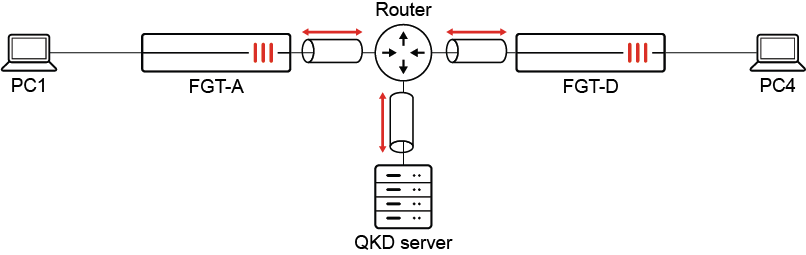

In this example, a quantum key distribution (QKD) system is deployed to perform central IPsec key management. The FortiGates installed as security gateways will terminate large amount of IPsec tunnels.

Configure FGT-A:
Configure the QKD profile:
config vpn qkd edit "qkd_1" set server "172.16.200.83" set port 8989 set id "FGT-A" set peer "qkd" set certificate "FGT_qkd1" next end -
Configure the IPsec phase 1 interface settings:
config vpn ipsec phase1-interface edit "site1" set interface "wan1" set peertype any set net-device disable set proposal aes128-sha256 aes256-sha256 aes128-sha1 aes256-sha1 set qkd allow set qkd-profile "qkd_1" set remote-gw 173.1.1.1 set psksecret ********** next end -
Configure the IPsec phase 2 interface settings:
config vpn ipsec phase2-interface edit "site1" set phase1name "site1" set proposal aes128-sha1 aes256-sha1 aes128-sha256 aes256-sha256 aes128gcm aes256gcm chacha20poly1305 next end
Configure FGT-D:
config vpn qkd edit "qkd_1" set server "172.16.200.83" set port 8989 set id "FGT-D" set peer "qkd" set certificate "FGT_qkd3" next end -
config vpn ipsec phase1-interface edit "site2" set interface "port25" set peertype any set net-device disable set proposal aes128-sha256 aes256-sha256 aes128-sha1 aes256-sha1 set qkd require set qkd-profile "qkd_1" set remote-gw 11.101.1.1 set psksecret ********** next end -
config vpn ipsec phase2-interface edit "site2" set phase1name "site2" set proposal aes128-sha1 aes256-sha1 aes128-sha256 aes256-sha256 aes128gcm aes256gcm chacha20poly1305 next end
