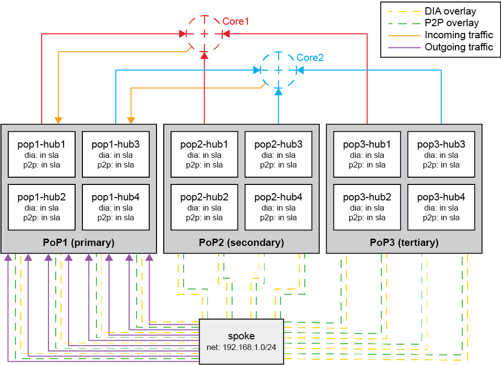

SD-WAN multi-PoP multi-hub large scale design and failover
FortiOS 7.2.0 introduced a feature to define the minimum number of SD-WAN interface members that must meet SLA in order for the spoke to select a hub to process its SD-WAN traffic. This design is suitable for a single-PoP multi-hub architecture in order to achieve hub-to-hub failover. See Using multiple members per SD-WAN neighbor configuration.
In FortiOS 7.4.1 and later, the design is enhanced to support a multi-PoP multi-hub architecture in which incoming and outgoing traffic failover between PoPs is supported.
Based on the preceding diagram, incoming and outgoing traffic to the spoke is preferred over PoP1. If a single hub within PoP1 goes out of SLA, traffic will continue to flow through the PoP. If the minimum number of members to meet SLA in the PoP cannot be met, then traffic will fail over to PoP2.
The following enhancements have been made to support the multi-PoP failover scenario.

Outgoing path control
The outgoing path from spoke to hub operates as follows:
Overlays to the primary and secondary PoP are assigned separately into an SD-WAN primary and secondary zone on the spoke.
One SD-WAN service rule is defined to include these zones as SD-WAN members.
When the primary zone is in SLA (
minimum-sla-meet-membersis met), the SD-WAN service rule steers traffic to the in SLA overlay members. -
When the primary zone is out of SLA (
minimum-sla-meet-membersis not met), the SD-WAN service rule steers traffic to the in SLA overlay members in the secondary zone. -
When the primary zone SLA is recovered:
If
sla-sticknessis disabled on the SD-WAN service rule, then traffic will wait the duration of thehold-down-timebefore switching back to in SLA overlays in the primary zone. -
If
sla-sticknessis enabled on the SD-WAN service rule, then existing traffic will be kept on the in SLA overlays on the secondary zone, but new traffic will be steered to in SLA overlays in the primary zone.
Incoming path control
The incoming traffic from the core/external peers, to PoP, to spoke operates as follows:
When the primary zone is in SLA, the spoke uses the preferable route map to advertise local routes with the in SLA community to hubs in the primary and secondary PoPs.
Hubs in the primary PoP translate the in SLA community into a short AS path and advertise it to external peers to attract incoming traffic.
Hubs in the secondary PoP translate the in SLA community into a longer AS path and advertise it to external peers to deflect incoming traffic.
If the number of in SLA overlays in the primary zone is less than the
minimum-sla-meet-members, then the spoke will use the default route map to advertise routes instead of with an out of SLA community to hubs in the primary PoP.-
Hubs in the primary PoP translate the out of SLA community into a longest AS path, and advertise it to external peers to deflect incoming traffic.
As a result, inbound traffic is routed to hubs in the secondary PoP.
The spoke will wait the duration of the predefined
hold-down-timein the SD-WAN service rule to use the preferable route map again to advertise routes with the in SLA community to hubs in the primary PoP. -
As a result, inbound traffic will be routed back to hubs in the primary PoP.

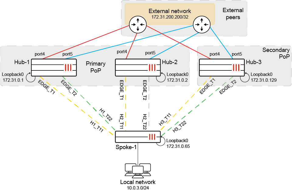

Example
This example configuration contains the following components:
Two PoPs:
The primary PoP has two hubs (Hub-1 and Hub-2).
The secondary PoP has one hub (Hub-3).
Spoke-1 has six overlays, with two overlay connections to each hub.
Spoke-1 has three BGP neighbors, with one BGP neighbor for each hub.
All BGP neighbors are established on loopback IPs.
Each hub has two paths to external peers.
Normally, outbound and inbound traffic go through hubs in the primary PoP. If the number of in SLA overlays to the primary PoP is less than the minimum-sla-meet-members (set to 2 in this example), bi-directional traffic needs to be switched to hubs in the secondary PoP. But when the primary PoP recovers and the minimum-sla-meet-members is met again, bi-directional traffic is forced back to hubs in the primary PoP after the predefined hold-down-time duration.

Send traffic from a host behind Spoke-1 to 172.31.200.200.
Run a sniffer trace on Spoke-1. Traffic leaves and returns on the H3_T11 overlay:
Spoke-1 (root) # diagnose sniffer packet any 'host 172.31.200.200' 4 interfaces=[any] filters=[host 172.31.200.200] 38.501449 port4 in 10.0.3.2 -> 172.31.200.200: icmp: echo request 38.501519 H3_T11 out 10.0.3.2 -> 172.31.200.200: icmp: echo request 38.501818 H3_T11 in 172.31.200.200 -> 10.0.3.2: icmp: echo reply 38.501845 port4 out 172.31.200.200 -> 10.0.3.2: icmp: echo reply
Test case 5: an SD-WAN member on PoP1 recovers
SD-WAN member H2_T11 recovers and brings the number of overlays in SLA back to being above the minimum-sla-meet-members threshold in PoP1. After the hold down time duration (30 seconds), in SLA overlays in zone PoP1 are preferred over PoP2 again. With sla-stickiness enabled, existing traffic is kept on H3_T11, but new traffic is steered to H2_T11.
To verify the configuration:
Verify the SD-WAN service rules status on Spoke-1. The hold down timer has not yet passed, so H2_T11 is not yet preferred—even though the SLA status is pass/alive:
Spoke-1 (root) # diagnose sys sdwan service Service(1): Address Mode(IPV4) flags=0x1c200 use-shortcut-sla use-shortcut sla-stickiness Tie break: cfg Gen(16), TOS(0x0/0x0), Protocol(0): src(1->65535):dst(1->65535), Mode(sla), sla-compare-order Hold down time(30) seconds, Hold start at 431972 second, now 432000 Service role: standalone Members(6): 1: Seq_num(5 H3_T11 PoP2), alive, sla(0x1), gid(0), cfg_order(1), local cost(0), selected 2: Seq_num(6 H3_T22 PoP2), alive, sla(0x1), gid(0), cfg_order(1), local cost(0), selected 3: Seq_num(1 H1_T11 PoP1), alive, sla(0x0), gid(0), cfg_order(0), local cost(0), selected 4: Seq_num(2 H1_T22 PoP1), alive, sla(0x0), gid(0), cfg_order(0), local cost(0), selected 5: Seq_num(3 H2_T11 PoP1), alive, sla(0x1), gid(0), cfg_order(0), local cost(0), selected 6: Seq_num(4 H2_T22 PoP1), alive, sla(0x1), gid(0), cfg_order(0), local cost(0), selected -
Verify the SD-WAN service rules status again after the hold down timer passes. H2_T11 and H2_T22 from PoP1 are now preferred:
Spoke-1 (root) # diagnose sys sdwan service Service(1): Address Mode(IPV4) flags=0x1c200 use-shortcut-sla use-shortcut sla-stickiness Tie break: cfg Gen(17), TOS(0x0/0x0), Protocol(0): src(1->65535):dst(1->65535), Mode(sla), sla-compare-order Hold down time(30) seconds, Hold start at 432003 second, now 432003 Service role: standalone Members(6): 1: Seq_num(3 H2_T11 PoP1), alive, sla(0x1), gid(0), cfg_order(0), local cost(0), selected 2: Seq_num(4 H2_T22 PoP1), alive, sla(0x1), gid(0), cfg_order(0), local cost(0), selected 3: Seq_num(5 H3_T11 PoP2), alive, sla(0x1), gid(0), cfg_order(1), local cost(0), selected 4: Seq_num(6 H3_T22 PoP2), alive, sla(0x1), gid(0), cfg_order(1), local cost(0), selected 5: Seq_num(1 H1_T11 PoP1), alive, sla(0x0), gid(0), cfg_order(0), local cost(0), selected 6: Seq_num(2 H1_T22 PoP1), alive, sla(0x0), gid(0), cfg_order(0), local cost(0), selected -
Verify the BGP learned routes on Hub-2, which now receives community 10:1 from Spoke-1:
PoP1-Hub2 (root) # get router info bgp network 10.0.3.0/24 VRF 0 BGP routing table entry for 10.0.3.0/24 Paths: (1 available, best #1, table Default-IP-Routing-Table) Not advertised to any peer Original VRF 0 Local, (Received from a RR-client) 172.31.0.65 from 172.31.0.65 (172.31.0.65) Origin IGP metric 0, localpref 100, valid, internal, best Community: 10:1 Last update: Tue Jul 18 14:41:32 2023 -
Run a sniffer trace on Spoke-1. Because of
sla-stickiness, the existing traffic is kept on H3_T11:Spoke-1 (root) # diagnose sniffer packet any 'host 172.31.200.200' 4 interfaces=[any] filters=[host 172.31.200.200] 0.202708 port4 in 10.0.3.2 -> 172.31.200.200: icmp: echo request 0.202724 H3_T11 out 10.0.3.2 -> 172.31.200.200: icmp: echo request 0.202911 H3_T11 in 172.31.200.200 -> 10.0.3.2: icmp: echo reply 0.202934 port4 out 172.31.200.200 -> 10.0.3.2: icmp: echo reply
Test case 6: Hub-1 has an in SLA path to external peers
Since Hub-1 has an in SLA path to external peers, it will advertise the external route with destination 172.31.200.200/32 to Spoke-1.
Verify the health check status on Hub-1. Note that port4 meets SLA, but port5 does not:
PoP1-Hub1 (root) # diagnose sys sdwan health-check Health Check(external_peers): Seq(1 port4): state(alive), packet-loss(0.000%) latency(0.161), jitter(0.009), mos(4.404), bandwidth-up(999999), bandwidth-dw(999999), bandwidth-bi(1999998) sla_map=0x1 Seq(2 port5): state(dead), packet-loss(100.000%) sla_map=0x0
Verify the SD-WAN neighbor status. The
minimum-sla-meet-membersthreshold of 1 is still met:PoP1-Hub1 (root) # diagnose sys sdwan neighbor Neighbor(EDGE): member(1 2)role(standalone) Health-check(external_peers:1) sla-pass selected alive -
Verify the BGP learned routes. Hub-1 still advertises the external route to the Spoke-1 BGP neighbor:
PoP1-Hub1 (root) # get router info bgp neighbors 172.31.0.65 advertised-routes VRF 0 BGP table version is 13, local router ID is 172.31.0.1 Status codes: s suppressed, d damped, h history, * valid, > best, i - internal Origin codes: i - IGP, e - EGP, ? - incomplete Network Next Hop Metric LocPrf Weight RouteTag Path *>i172.31.200.200/32 172.31.0.1 100 32768 0 i <-/-> Total number of prefixes 1
Test case 7: all external peers on Hub-1 are out of SLA
In this case, Hub-1 will now advertise the default route map, which denies the advertisement of the external route. Spoke-1 will now route traffic to the next hub.
Verify the health check status on Hub-1. Note that port4 and port5 do not meet SLA:
PoP1-Hub1 (root) # diagnose sys sdwan health-check Health Check(external_peers): Seq(1 port4): state(dead), packet-loss(100.000%) sla_map=0x0 Seq(2 port5): state(dead), packet-loss(100.000%) sla_map=0x0
minimum-sla-meet-membersthreshold of 1 is not met:PoP1-Hub1 (root) # diagnose sys sdwan neighbor Neighbor(EDGE): member(1 2)role(standalone) Health-check(external_peers:1) sla-fail dead -
Verify the BGP learned routes. Hub-1 does not advertise any external routes to the Spoke-1 BGP neighbor:
PoP1-Hub1 (root) # get router info bgp neighbors 172.31.0.65 advertised-routes % No prefix for neighbor 172.31.0.65
