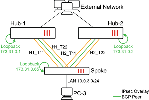

Example
This example includes one spoke and two hubs:
  • The spoke has two overlays to Hub-1 and Hub-2 respectively.
  • BGP neighbors between the spoke and hubs are over loopback IP addresses
  • SD-WAN is configured on the spoke.
To configure and test the example:

    The routes with MEDs are advertised to a router on the external network that establishes a BGP neighbor relationship with Hub-1 and Hub-2. When sending traffic destined for 10.0.3.0/24, the router on the external network will prefer to send traffic to the hub with the lower MED.
  3. All overlays are in SLA.
    When sending traffic destined for 10.0.3.0/24, the router on the external network will prefer to send traffic to Hub-1 with lower MED 50 over Hub-2 with higher MED 60.
  1. Enable recursive inherit priority on the hubs:
    config router bgp
        set recursive-inherit-priority enable
    See Embedded SD-WAN SLA information in ICMP probes for more information.
  2. Configure SD-WAN on the spoke:
    config system sdwan
        set status enable
        config zone
            edit "overlay"
        config members
            edit 4
                set interface "H1_T11"
                set zone "overlay"
                set source 172.31.0.65
                set priority-in-sla 50
                set priority-out-sla 100
            edit 5
                set interface "H1_T22"
                set zone "overlay"
                set priority-in-sla 70
                set priority-out-sla 120
            edit 7
                set interface "H2_T11"
                set zone "overlay"
                set priority-in-sla 60
                set priority-out-sla 110
            edit 8
                set interface "H2_T22"
                set zone "overlay"
                set priority-in-sla 80
                set priority-out-sla 130
        config health-check
            edit "HUB"
                set server "172.31.100.100"
                set embed-measured-health enable
                set sla-id-redistribute 1
                set sla-fail-log-period 10
                set sla-pass-log-period 10
                set members 4 5 7 8
                config sla
                        set link-cost-factor latency
                        set latency-threshold 100
        config neighbor
            edit "172.31.0.1"
                set member 4 5
                set route-metric priority
                set health-check "HUB"
            edit "172.31.0.2"
                set member 7 8
