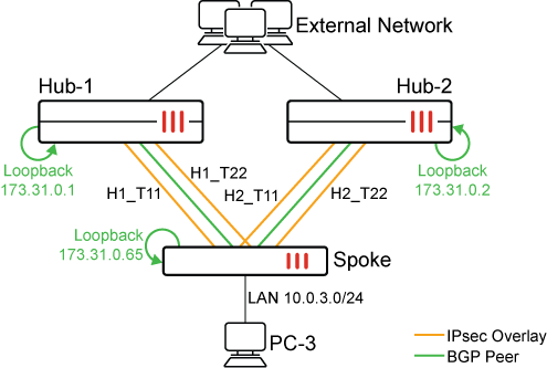

Example
This example includes one spoke and two hubs:
  • The spoke has two overlays to Hub-1 and Hub-2 respectively.
  • BGP neighbors between the spoke and hubs are over loopback IP addresses
  • SD-WAN is configured on the spoke.
To configure and test the example:
  1. Enable recursive inherit priority on the hubs:
    config router bgp
        set recursive-inherit-priority enable
    See Embedded SD-WAN SLA information in ICMP probes for more information.

    The routes with MEDs are advertised to a router on the external network that establishes a BGP neighbor relationship with Hub-1 and Hub-2. When sending traffic destined for 10.0.3.0/24, the router on the external network will prefer to send traffic to the hub with the lower MED.
  3. All overlays are in SLA.
    When sending traffic destined for 10.0.3.0/24, the router on the external network will prefer to send traffic to Hub-1 with lower MED 50 over Hub-2 with higher MED 60.
    config router bgp
  2. Configure SD-WAN on the spoke:
