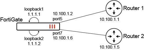

The preferred source IP can be configured on SD-WAN members so that local-out traffic is sourced from that IP. In the following example, two SD-WAN members (port5 and port7) will use loopback1 and loopback2 as sources instead of their physical interface address. A static route is created for destination 200.0.0.0/24 to use the virtual-wan-link. In turn, the FortiGate will create two ECMP routes to the member gateways and source the traffic from the loopback IPs.

    Traffic exiting each interface is sourced from the corresponding loopback IP.
