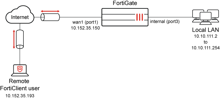

Dialup IPsec VPN traditionally relies on UDP but can now operate over TCP. This enhancement enables VPN traffic from FortiClient to traverse restrictive firewalls that only permit TCP-based traffic. You can configure an IPsec VPN tunnel to exclusively use UDP or TCP, or you can configure the tunnel automatically switch to TCP mode when the firewall blocks UDP.
In high-latency or congested networks, UDP-based VPN connections may suffer from packet loss or performance degradation. TCP, with its built-in error correction and retransmission mechanisms, enhances the reliability and stability of VPN connections in such environments.
Dialup IPsec over TCP is particularly advantageous in mobile or dynamic settings such as public WiFi, hotel networks, or cellular data where network conditions and restrictions often vary. This feature ensures more seamless and dependable VPN connectivity across a broader range of scenarios.
The custom TCP port functionality for IPsec is exclusively supported with IKE version 2 (IKEv2), and does not support NPU offloading.
Example
In this example, FortiGate is configured as a dialup IPsec server using IKE version 2 (IKEv2) and operating on a custom TCP port (5500). IKEv2 is configured to use EAP for user authentication. The initial setup leverages the VPN wizard to create the dialup IPsec tunnel. After the tunnel is created by the wizard, you use the CLI to customize the IKE settings and enable the use of TCP port 5500.
On the client side, FortiClient is managed by FortiClient EMS and configured to act as the dialup IPsec client. The client is configured to connect to the FortiGate server over the custom TCP port 5500. This feature requires FortiClient 7.4.1 or later.
For a detailed description of the steps to configure FortiClient EMS to use the custom TCP port 5500 for IPsec VPN connections, see IPsec VPN over TCP.

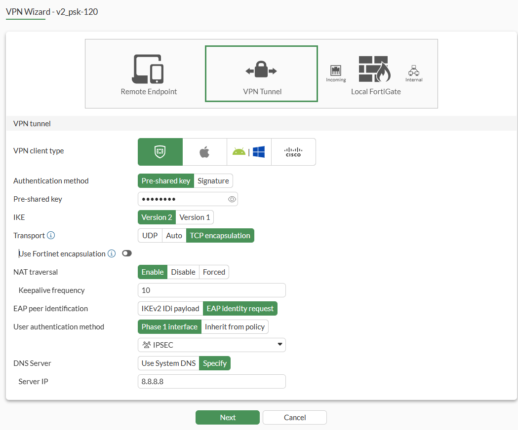

To configure FortiGate as IPsec dialup server using VPN Wizard:
  1. Go to VPN > VPN Wizard, and enter the following:

  3. Under VPN Tunnel section, enter the following:
    Field
    Value
    VPN client type
    FortiClient
    Authentication method
    Pre-shared key
    Pre-shared key
    Enter suitable key
    IKE
    Version 2
    Transport
    TCP encapsulation
    Use Fortinet encapsulation
    Disable
    The Fortinet propriety feature is designed to offload IPsec VPN traffic to Fortinet’s NP (Network Processor) ASICs to improve performance. This command enables or disables encapsulation of ESP (Encapsulating Security Payload) packets within non-standard TCP headers.
    • disable: Encapsulates ESP packets using standard TCP headers. This is the default option.
    • enable: Encapsulates ESP packets using non-standard TCP headers.
    This feature is not supported in the following scenarios:
    • When FortiGate is configured as Dialup IPsec VPN server for remote access when using FortiClient as dialup client.
    • In multi-vendor environments that use TCP encapsulation for ESP packets.
    Make sure that this setting is disabled for these two scenarios to ensure uninterrupted ESP packet flow encapsulated within real TCP headers.
    NAT traversal
    Enable
    Keepalive frequency
    10
    EAP peer identification
    EAP identity request
    User authentication method
    Phase 1 interface
    Use dropdown to select user group IPSEC. To configure user groups for authentication, see User groups.
    (Optional) To use multiple user groups, select Inherit from policy. See Using single or multiple user groups for user authentication for details.
    DNS Server
    Specify
    Server IP
    8.8.8.8

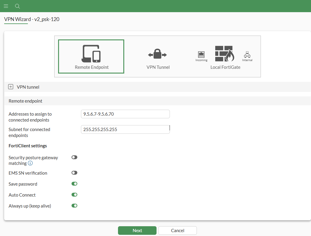

  5. Under Remote Endpoint section, enter the following:
    Field
    Value
    Address to assign to connected endpoints
    9.5.6.7-9.5.6.70
    Subnet for connected endpoints
    255.255.255.255
    FortiClient settings
    Security posture gateway matching
    Disable
    EMS SN verification
    Disable
    Save password
    Enable
    Auto Connect
    Enable
    Always up (keep alive)
    Enable
  6. Click Next.

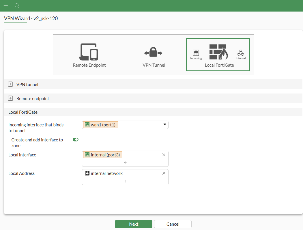

  7. Under Local FortiGate section, enter the following:
    Field
    Value
    Incoming interface that binds to tunnel
    wan1(port1)
    Create and add interface to Zone
    Enable
    Local interface
    internal (port3)
    Local Address
    internal network
  8. Click Next.

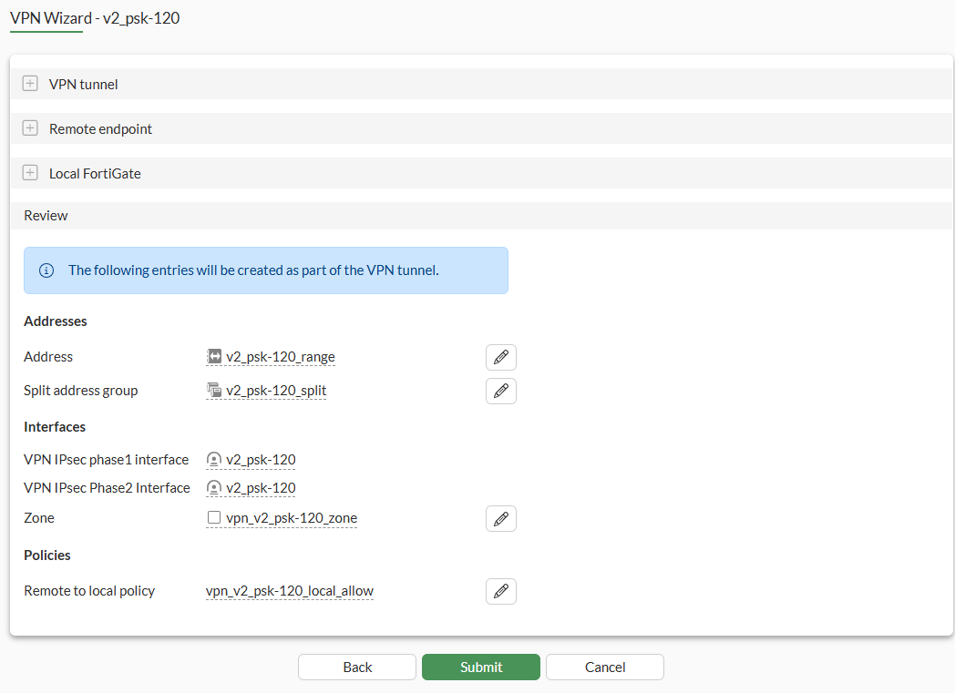

  9. Under Review section, review the configuration pending configuration by the wizard.
  10. Click Submit.

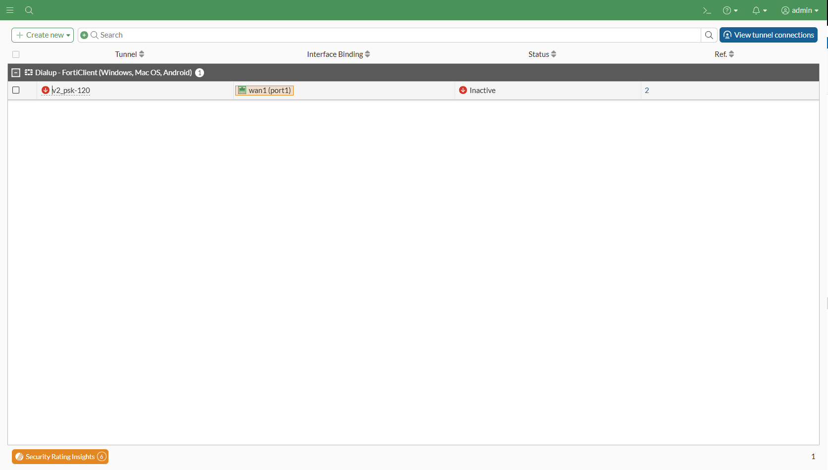

    The tunnel is configured and visible under VPN > VPN Tunnels.

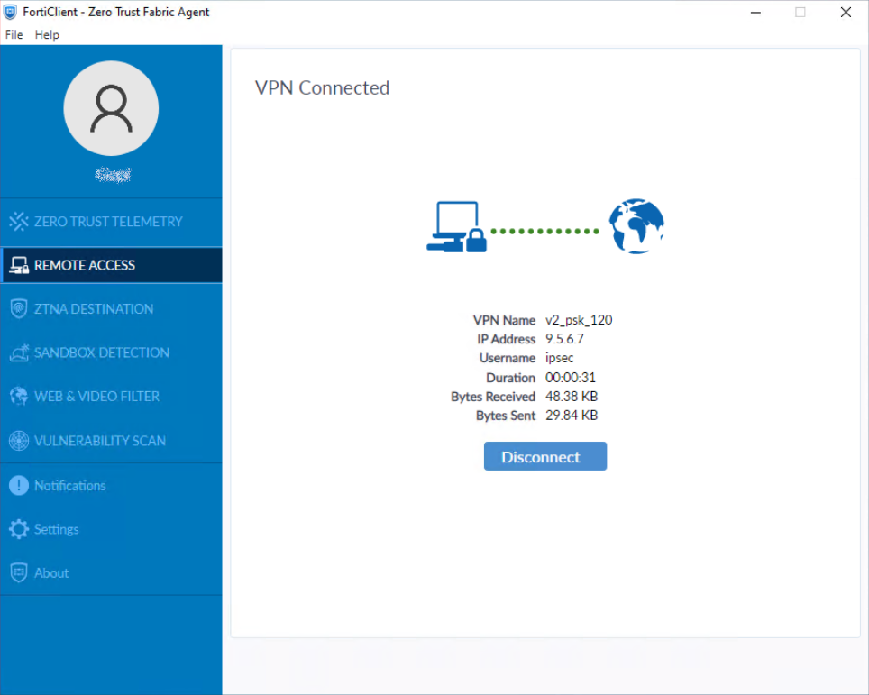

To verify the VPN connection:
  1. Using FortiClient, connect to the IPsec VPN gateway.
  2. On FortiGate, run diagnose vpn ike gateway list to verify the IPsec VPN tunnel status.
    Note that addr shows the custom TCP port value, and transport shows TCP:

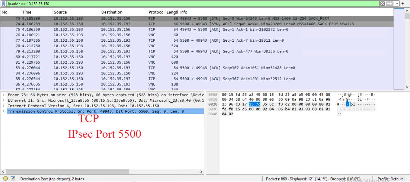

  3. Run a packet capture using the packet capture tool on FortiGate GUI under Network > Diagnostic tab for wan1(port1) interface with TCP port number 5500.
    For more information, see Using the packet capture tool.
  4. (Optional) Run the packet capture using the following command:
    diagnose sniffer packet wan1 “port 5500” 4 0 l.
    For more information, see Performing a sniffer trace or packet capture.

    Field
    Value
    9.5.6.7-9.5.6.70
    255.255.255.255
    Disable
    EMS SN verification
    Disable
    Save password
    Enable
    Auto Connect
    Enable
    Enable
  6. Click Next.
    Field
    Value
    wan1(port1)
    Enable
    Local interface
    internal (port3)
    Local Address
    internal network
  8. Click Next.
  10. Click Submit.
