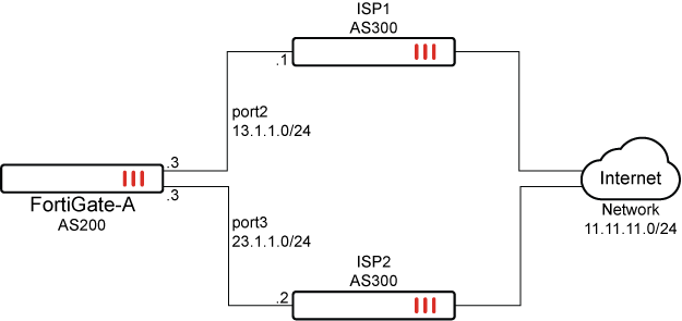

The following example discusses the use of MED in dual-homed AS network and the configuration of MED Path Attribute on FortiOS.
Characteristics of the topology include the following:
  • FortiGate-A has two internet service providers: ISP1 and ISP2.
  • FortiGate-A belongs to AS 200.
  • ISP1 and ISP2 both belong to AS 300.
  • FortiGate-A will establish eBGP peering relationships with ISP1 and ISP2.
  • Network 11.11.11.0/24 resides on the Internet and is reachable by both ISP1 and ISP2.
  • eBGP multipath is enabled on FortiGate-A if FortiGate-A needs to perform equal cost load-balancing of traffic between both ISP1 and ISP2 to reach to 11.11.11.0/24.
  • The network 11.11.11.0/24 on the Internet is being advertised by both ISP1 and ISP2 to FortiGate-A through eBGP.
For this example, the traffic originating from behind the FortiGate-A should prefer ISP1 rather than ISP2 to reach 11.11.11.0/24, and needs to use the BGP MED Path Attribute. This is done by configuring set set-metric in a route map configuration and ensuring the MED value of ISP1 is less than that of ISP2.
