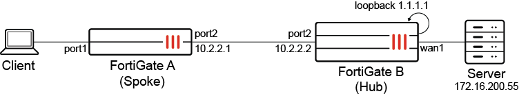

The use cases in this example are for a hub and spoke SD-WAN deployment. Traffic from the spoke (either real traffic or SLA health check probes) can be marked with a certain DSCP tag when leaving the spoke. QoS may be applied by an upstream device based on the DSCP tag. When the traffic arrives on the hub, the hub may also want to mark the reply traffic to the spoke with the same DSCP tag. This would allow QoS to be applied to the traffic in the reply direction as well, which is traffic in the hub to spoke direction associated with the same session in the spoke to hub direction.
While this topology simplifies the SD-WAN deployment into a single hub and spoke, this feature applies to the following configurations:

Use case 1: typical forwarding traffic
Traffic originates from the spoke and is destined for a server behind the hub. The spoke marks the traffic with a DSCP tag of 101010. This is done by enabling diffserv-foward on the spoke firewall policy. It can also be accomplished by enabling dscp-forward in an SD-WAN rule.
The hub allows the traffic in through a firewall policy. By enabling diffserv-copy on the firewall policy, it will mark the reply traffic on the corresponding sessions with the same DSCP tag in which it came.
To configure the FortiGates:

Use case 2: local-in traffic destined to a loopback interface
SLA health checks from the spoke are destined for a loopback interface on the hub. The health check is marked with a DSCP tag of 000001 by the spoke. When the hub receives the probes to its loopback, it will mark the replies with the same DSCP tags in which it came.
