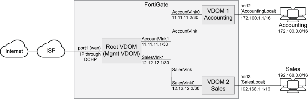

This example shows how to configure a FortiGate unit to use inter-VDOM routing to route outgoing traffic from individual VDOMs to a root VDOM with Internet access. See Inter-VDOM routing for more information.
Two departments of a company, Accounting and Sales, are connected to one FortiGate. The company uses a single ISP to connect to the Internet. This is an example of the Internet access configuration. See Topologies for details.
This example assumes that the interfaces of the FortiGate have already been configured with the IP addresses depicted in the preceding diagram.

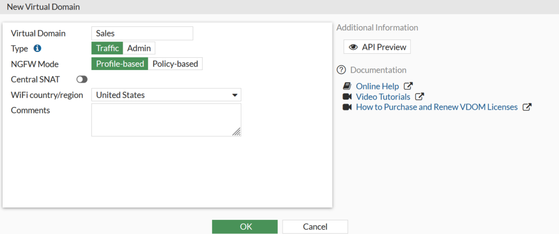

To create the Sales and Accounting VDOMs in the GUI:
  1. In the Global VDOM, go to System > VDOM.
  2. Click Create New.
  3. In the Virtual Domain field, enter Sales.
  4. If required, set the NGFW Mode. If the NGFW Mode is Profile-based, Central SNAT can be enabled.
  5. Click OK to create the VDOM.
  6. Repeat the above steps for Accounting.

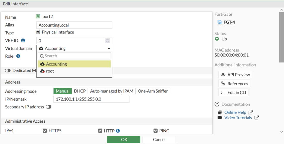

Assign interfaces to VDOMs
This example uses three interfaces on the FortiGate unit: port2 (AccountingLocal), port3 (SalesLocal), and port1 (WAN). Port2 and port3 interfaces each have a department’s network connected. Port1 is for all traffic to and from the Internet and uses DHCP to configure its IP address, which is common with many ISPs.
To assign interfaces to VDOMs in the GUI:
  1. In the Global VDOM, go to Network > Interfaces.
  2. Select port2 and click Edit.
  3. From the Virtual domain list, select Accounting.
  4. Click OK.
  5. Repeat the preceding steps to assign port3 to the Sales VDOM.
  6. Repeat the preceding steps to assign port1 to the root VDOM.
Configure the VDOM links
To complete the connection between each VDOM and the management VDOM, add the two VDOM links. One pair is the Accounting – management link and the other is the Sales – management link. Each side of these links will be assigned IP addresses since they will be handy in configuring inter-VDOM routing in the next step.
To configure the Accounting and management VDOM link in the GUI:
  2. Select Create New > VDOM Link.
  3. Enter the following information:
    Name AccountVlnk
    Interface 0
    Virtual Domain Accounting
    IP/Netmask
    11.11.11.2/255.255.255.252
    Administrative Access
    HTTPS, PING, SSH
    Comment
    Accounting side of the VDOM link
    Interface 1
    Virtual Domain
    root
    IP/Netmask
    11.11.11.1/255.255.255.252
    HTTPS, PING, SSH
    Comment
    Management side of the VDOM link

To configure the Sales and management VDOM link in the GUI:
  2. Select Create New > VDOM link.
    Name SalesVlnk
    Interface 0
    Virtual Domain Sales
    IP/Netmask
    12.12.12.2/255.255.255.252
    HTTPS, PING, SSH
    Comment
    Interface 1
    Virtual Domain
    root
    IP/Netmask
    12.12.12.1/255.255.255.252
    HTTPS, PING, SSH
    Comment
  4. Click OK.
  4. Click OK.
    Name AccountVlnk
    Interface 0
    IP/Netmask
    HTTPS, PING, SSH
    Comment
    Interface 1
    Virtual Domain
    root
    IP/Netmask
    HTTPS, PING, SSH
    Comment

Configure inter-VDOM routing
A default static route can be configured on each VDOM to provide Internet access. In other words, this static route would provide inter-VDOM routing between each department VDOM and the root VDOM.
For this static route, these settings are used:
  • Default Gateway: IP address of the management side of the VDOM link
    • Accounting VDOM: 11.11.11.1
    • Sales VDOM: 12.12.12.1
  • Interface: Interface on the department VDOM side of the VDOM link
    • Accounting VDOM: AccountVlnk0
    • Sales VDOM: SalesVlnk0
  • IP address: 0.0.0.0/0.0.0.0 (default)
