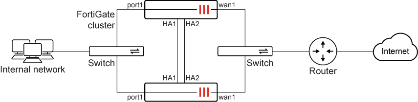

The FortiGate Clustering Protocol (FGCP) provides failover protection, meaning that a cluster can provide FortiGate services even when one of the devices in the cluster encounters a problem that would result in the complete loss of connectivity for a stand-alone FortiGate unit. Failover protection provides a backup mechanism that can be used to reduce the risk of unexpected downtime, especially in mission-critical environments.
FGCP supports failover protection in four ways:
  1. If a link fails.
  2. If a device loses power.
  3. If an SSD fails.
  4. If memory utilization exceeds the threshold for a specified amount of time.
When session-pickup is enabled in the HA settings, existing TCP session are kept, and users on the network are not impacted by downtime as the traffic can be passed without reestablishing the sessions.
When and how the failover happens
  1. Link fails
    Before triggering a failover when a link fails, the administrator must ensure that monitor interfaces are configured. Normally, the internal interface that connects to the internal network, and an outgoing interface for traffic to the internet or outside the network, should be monitored. Any of those links going down will trigger a failover.
  2. Loss of power for active unit
    When an active (primary) unit loses power, a backup (secondary) unit automatically becomes the active, and the impact on traffic is minimal. There are no settings for this kind of fail over.
