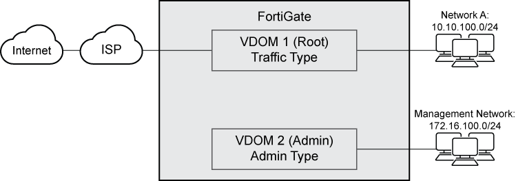

VDOM types
When a FortiGate is in multi-VDOM mode, a VDOM can be configured as an Admin, Traffic, or LAN extension type VDOM.
When the VDOM type is set to Admin, the VDOM is used to administer and manage the FortiGate. Usually, the Admin VDOM resides in a management network which is only accessible by administrators. Global and VDOM administrators can log in to the FortiGate using SSH, HTTPS, and so on but traffic cannot pass through this Admin VDOM. A FortiGate does not need to have an Admin VDOM and, at most, there can only be one Admin VDOM per FortiGate.
When VDOM type is set to Traffic, the VDOM can pass traffic like a regular firewall. Most VDOMs will be Traffic type VDOMs. Network interfaces on a Traffic VDOM can also enable SSH, HTTPS, and so on for administrative and management purposes.
In general, an Admin VDOM has a subset of a Traffic VDOM’s capabilities. See Configure an administrative VDOM type for configuration details.

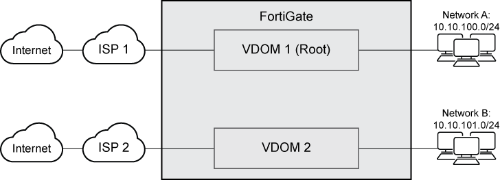

Independent VDOMs
Multiple, completely separate VDOMs are created. Any VDOM can be the management VDOM, as long as it has Internet access to connect to FortiGuard services and other management resources. There are no inter-VDOM links, and each VDOM is independently managed.

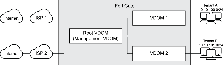

Meshed VDOMs
VDOMs can communicate with inter-VDOM links. In full-mesh configurations, all the VDOMs are interconnected. In partial-mesh configurations, only some of the VDOMs are interconnected.
In this configuration, inter-vdom links between tenants are created by the global administrator, but each tenant controls the firewall policies to allow access to other tenants.
See Inter-VDOM routing and Inter-VDOM routing configuration example: Internet access for configuration details.
Administrative VDOM on a management network
The administrative VDOM type can be used to limit administrative access to the FortiGate using SSH, HTTPS and so on to administrators working from a management network. Administrators may be limited to management settings or may have global privileges to access other VDOMs. The user or tenant network (depicted as Network A in the diagram) uses a traffic type VDOM, which allows traffic to pass through it like a regular firewall and allows configuration of firewall-related settings. This configuration can improve security if the management network is a closed network and administrative access is not enabled on any interfaces on the traffic VDOM.

VDOM types

Independent VDOMs

Meshed VDOMs
