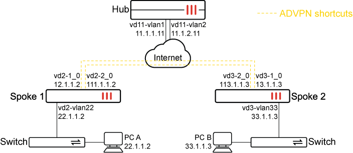

In this example SD-WAN is configured between one hub and multiple spokes, and the SD-WAN configuration shows SD-WAN rule 3 with the following required settings to enable spoke-to-spoke traffic between multiple ADVPN shortcuts:
  • set load-balance enable
  • set tie-break fib-best-match

To trigger spoke-to-spoke communication, run an ICMP ping on PC A with IP address 22.1.1.22 behind spoke 1 that is destined for PC B with IP address 33.1.1.33 behind spoke 2. The spoke-to-spoke traffic will be used to demonstrate load balancing between shortcuts in the CLI output of this topic.

Use maximize bandwidth to load balance traffic between ADVPN shortcuts
When ADVPN is configured on a FortiGate spoke along with an SD-WAN rule set to Maximize Bandwidth SLA (GUI) or load balance mode (CLI) as well as tie-break set to fib-best-match, then spoke-to-spoke traffic is load balanced between multiple ADVPN shortcuts when the shortcuts are within the configured SLA conditions.
Following is an example configuration with load-balance enabled and tie-break set to fib-best-match:

Example
To verify the configuration:

  6. Check the sniffer packet output after changing the setting to set tie-break fib-best-match.
    The following packet sniffer output of ICMP pings demonstrates how load balancing of spoke-to-spoke is limited and only occurs between shortcuts vd2-1_0 and vd2-2_0, which are within SLA.

  7. Check SD-WAN health.
    When an ADVPN shortcut is out of SLA, traffic does not run on it. Shortcut vd2-1_0 is out of SLA.
    # diagnose system sdwan health-check
    Health Check(ping):
    Seq(1 vd2-1): state(alive), packet-loss(6.000%) latency(0.026), jitter(0.001), mos(4.401), bandwidth-up(1999), bandwidth-dw(0), bandwidth-bi(1999) sla_map=0x0
    Seq(1 vd2-1_0): state(alive), packet-loss(18.182%) latency(0.033), jitter(0.003), mos(4.395), bandwidth-up(2000), bandwidth-dw(0), bandwidth-bi(2000) sla_map=0x0
    Seq(2 vd2-2): state(alive), packet-loss(0.000%) latency(0.024), jitter(0.001), mos(4.404), bandwidth-up(0), bandwidth-dw(0), bandwidth-bi(0) sla_map=0x3
    Seq(2 vd2-2_0): state(alive), packet-loss(0.000%) latency(0.033), jitter(0.005), mos(4.404), bandwidth-up(0), bandwidth-dw(0), bandwidth-bi(0) sla_map=0x3
  8. Check the sniffer packet:
    No traffic runs on Shortcut vd2-1_0 because it is out of SLA.

Administrators can use the set use-shortcut-sla disable command in an SD-WAN rule to ignore the shortcut's SLA and use the parent tunnel SLA instead. When combined with set tie-break fib-best-match, spoke-to-spoke traffic will be sent across the shortcut while the parent tunnel SLA is healthy, regardless of the shortcut tunnel's SLA.
