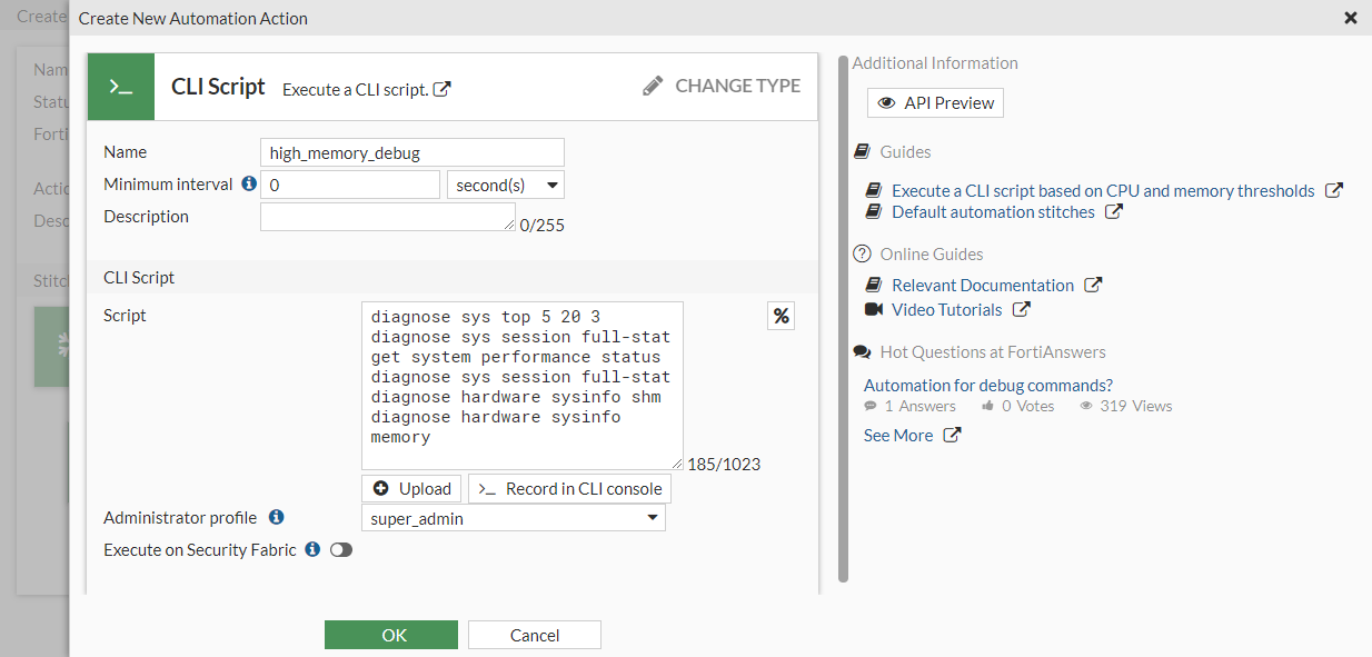

  4. Configure the CLI Script action:
    1. Click Add Action.
    2. Click Create and select CLI Script.
    3. Enter the following:
      Name
      high_memory_debug
      Script
      diagnose sys top 5 20 3
      diagnose sys session full-stat
      get system performance status
      diagnose hardware sysinfo shm
      diagnose hardware sysinfo memory
      Administrator profile
      Select a profile
    4. Click OK.
    5. Select the action in the list and click Apply.

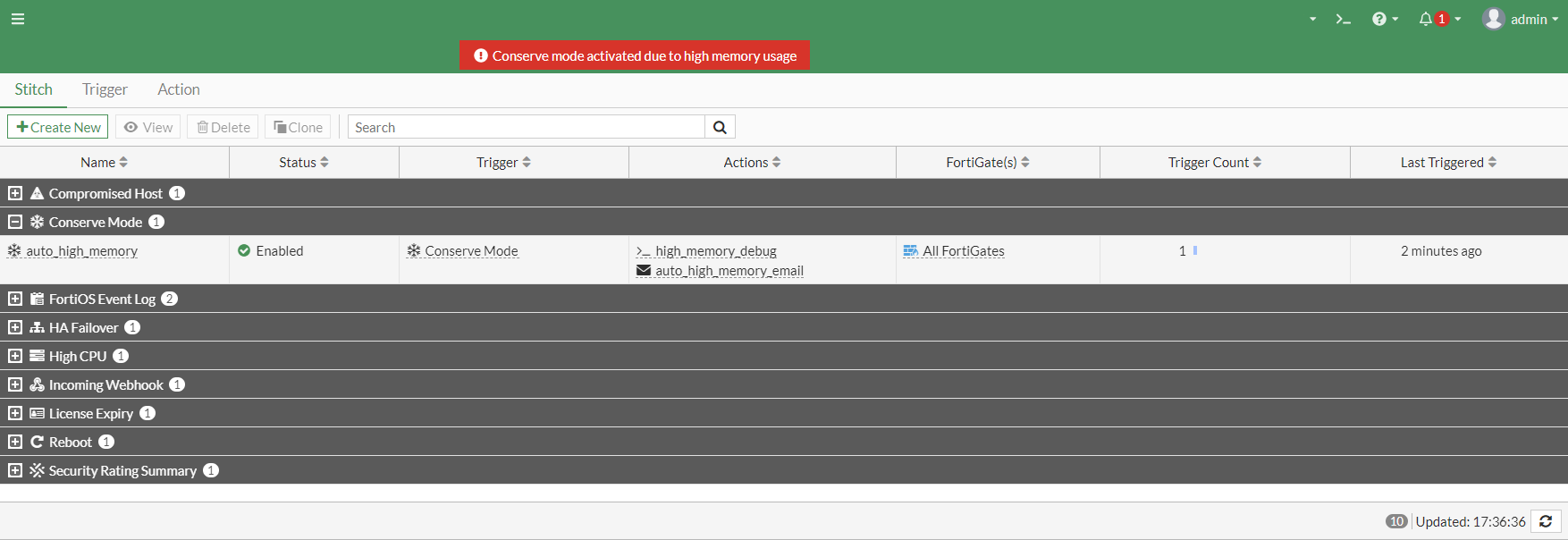

Results
When the FortiGate enters conserve mode due to the memory-use-threshold-red being exceeded, the GUI displays a notice, and the auto_high_memory automation stitch is triggered. This causes the CLI script to run and the script results are emailed to the specified address.
      Name
      high_memory_debug
      Script
      Select a profile
    4. Click OK.

Results
