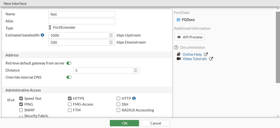

To create a virtual FortiExtender interface in the GUI:
Go to Network > Interfaces and click Create New > FortiExtender.
Enter a name for the interface.
Configure the remaining settings as needed. See Interface settings for more details.
Click OK.

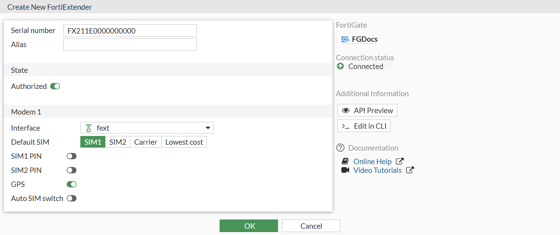

To add a FortiExtender in the GUI:
Go to Network > FortiExtender and click Create New > Extenders.
Enter your FortiExtender's serial number in the Serial number field.
Optionally, set an Alias for the FortiExtender.
In the State section, enable Authorized.
Set Interface to the FortiExtender interface.
Configure the remaining setting as required. See the FortiExtender Administration Guide (FGT-Managed) for more information.
Click OK.
In the extenders list, right-click on the FortiExtender and select Diagnostics and Tools to review the modem and SIM status, and other details about the FortiExtender.
To create a virtual FortiExtender interface in the CLI:
config system interface
edit "fext"
set vdom "root"
set mode dhcp
set allowaccess ping https speed-test
set type fext-wan
set role wan
set snmp-index 18
set estimated-upstream-bandwidth 1000
set estimated-downstream-bandwidth 500
To configure the FortiExtender in the CLI:
config extension-controller extender
edit "FX211E"
set authorized enable
set extension-type wan-extension
set profile <profile>
config wan-extension
set modem1-extension "fext"
The device-id is automatically configured by the FortiGate.
To verify the modem settings in the CLI:
get extender modem-status FX211E0000000000 1
Modem 0:
physical_port: 2-1.2
manufacture: Sierra Wireless, Incorporated
product: Sierra Wireless, Incorporated
