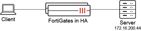

In this example, OpenSSL is used to create a TLS session between the client and the server through the primary FortiGate. The session ticket is outputted and saved. Upon failover, the same session ticket is reused to create a TLS session through the new primary unit. Because the new primary unit uses the same certificate to generate the key for the TLS session ticket, it allows the connection to be made using an abbreviated TLS handshake.
This example is for demonstration purposes only. In a normal failover, TLS sessions from clients will automatically be able to re-establish using an abbreviated handshake through the new primary unit.
