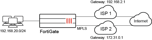

The FortiGate has multiple SD-WAN links and has formed BGP neighbors with both ISPs.
ISP1 is used primarily for outbound traffic, and has an SD-WAN service rule using the lowest cost algorithm applied to it. When SLAs for ISP1 are not met, it will fail over to the MPLS line.
Inbound traffic is allowed by both WAN links, with each WAN advertising a community string when SLAs are met. When SLAs are not met, the WAN links advertise a different community string.
This example uses two SD-WAN links. The topology can be expanded to include more links as needed.

  1. Verify the health check status:
    FortiGate-Branch # diagnose sys sdwan health-check
    Health Check(pingserver):
    Seq(2 MPLS): state(alive), packet-loss(0.000%) latency(24.709), jitter(14.996) sla_map=0x1
    Seq(1 port1): state(alive), packet-loss(0.000%) latency(28.771), jitter(14.840) sla_map=0x1
  2. Verify SD-WAN neighbor status:
    FortiGate-Branch # diagnose sys sdwan neighbor
    Neighbor(192.168.2.1): member(1) role(standalone)
            Health-check(pingserver:1)  sla-pass selected alive
    Neighbor(172.31.0.1): member(2) role(standalone)
  3. Verify service rules status:
    Because the service role is standalone, it matches both neighbors. The mode (SLA) determines that port1 is lower cost.
    FortiGate-Branch # diagnose sys sdwan service4
    Service(1): Address Mode(IPV4) flags=0x0
      Gen(1), TOS(0x0/0x0), Protocol(0: 1->65535), Mode(sla), sla-compare-order
      Service role: standalone
      Members:
        1: Seq_num(1 port1), alive, sla(0x1), cfg_order(0), cost(0), selected
        2: Seq_num(2 MPLS), alive, sla(0x1), cfg_order(1), cost(20), selected
      Src address:
            0.0.0.0-255.255.255.255
      Dst address:
  4. Verify neighbor routers:
    1. Primary neighbor router:
      FGT-NBR1 # get router info bgp network 192.168.20.0
      BGP routing table entry for 192.168.20.0/24
      Paths: (1 available, best #1, table Default-IP-Routing-Table)
        Not advertised to any peer
        64512
          192.168.2.5 from 192.168.2.5 (192.168.122.98)
            Origin IGP metric 0, localpref 100, valid, external, best
            Community: 64511:1
            Last update: Thu Apr 30 23:59:05 2020
    2. Secondary neighbor router:
      FGT-NBR2 # get router info bgp network 192.168.20.0
      VRF 0 BGP routing table entry for 192.168.20.0/24
        Original VRF 0
        64512
          172.31.0.2 from 172.31.0.2 (192.168.122.98)
            Community: 64522:1
            Last update: Fri May  1 00:11:28 2020
To verify that when neighbor ISP1 misses SLAs, MPLS is selected and BGP advertises a different community string for ISP1:
    Seq(2 MPLS): state(alive), packet-loss(0.000%) latency(25.637), jitter(17.820) sla_map=0x1
    Seq(1 port1): state(dead), packet-loss(16.000%) sla_map=0x0
            Health-check(pingserver:1)  sla-fail dead
    As SLA failed for neighbor ISP1, MPLS is preferred.
      Gen(3), TOS(0x0/0x0), Protocol(0: 1->65535), Mode(sla), sla-compare-order
      Members:
        1: Seq_num(2 MPLS), alive, sla(0x1), cfg_order(1), cost(20), selected
        2: Seq_num(1 port1), dead, sla(0x0), cfg_order(0), cost(0)
      Src address:
      Dst address:
    The community received on ISP1 is updated.
        64512
            Community: 64511:5
            Last update: Fri May  1 00:33:26 2020
        Original VRF 0
        64512
            Community: 64522:1
            Last update: Fri May  1 00:22:42 2020
