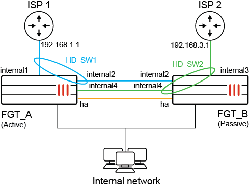

In this topology:
  • Two hardware switches are created, HD_SW1 and HD_SW2.
  • HD_SW1 is used to connect to ISP 1 Router and includes the internal1 and internal2 ports.
  • HD_SW2 is used to connect to ISP 2 Router and includes the internal3 and internal4 ports.
  • Another interface on each device is used as the HA heartbeat interface, connecting the two FortiGates in HA.
The FortiGates create two hardware switches to connect to ISP 1 and ISP2. When FGT_A is the primary device, it reaches ISP 1 on internal1 in HD_SW1 and ISP 2 on internal4 in HD_SW2. When FGT_B is the primary device, it reaches ISP 1 on internal2 in HD_SW1 and ISP 2 on internal3 on HD_SW2.
HA failover
This is not a standard HA configuration with external switches. In the case of a device failure, one of the ISPs will no longer be available because the switch that is connected to it will be down.
For example, If FGT_A loses power, HA failover will occur and FGT_B will become the primary unit. Its connection to internal2 on HD_SW1 will also be down, so it will be unable to connect to ISP 1. Its SD-WAN SLAs will be broken, and traffic will only be routed through ISP 2.
A link on a hardware switch cannot be monitored in HA monitor, so it is impossible to perform link failure when a port in either of the hardware switches fails. Performing a link failure is unnecessary in this configuration though, because any link failure on the hardware switch will be experienced by both cluster members. SD-WAN SLA health checks should be used to monitor the health of each ISP.

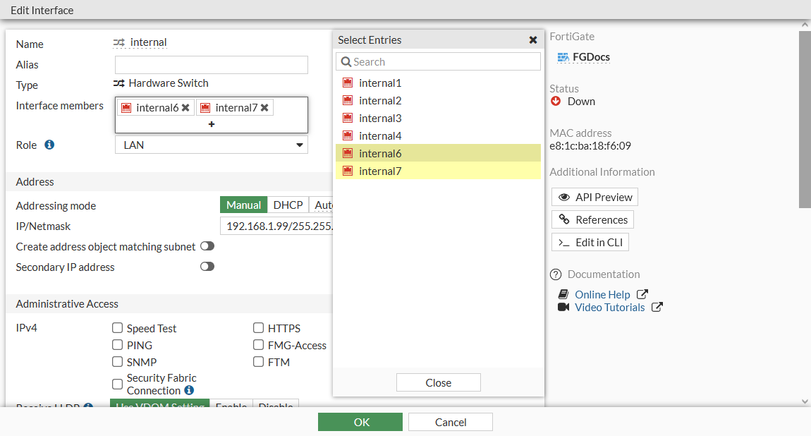

  3. Remove the existing interface members from the default hardware switch:
    1. Go to Network > Interfaces.
    2. In the LAN section, double-click the internal interface to edit it.
    3. In Interface Members, remove all of the interfaces
    4. Click OK.

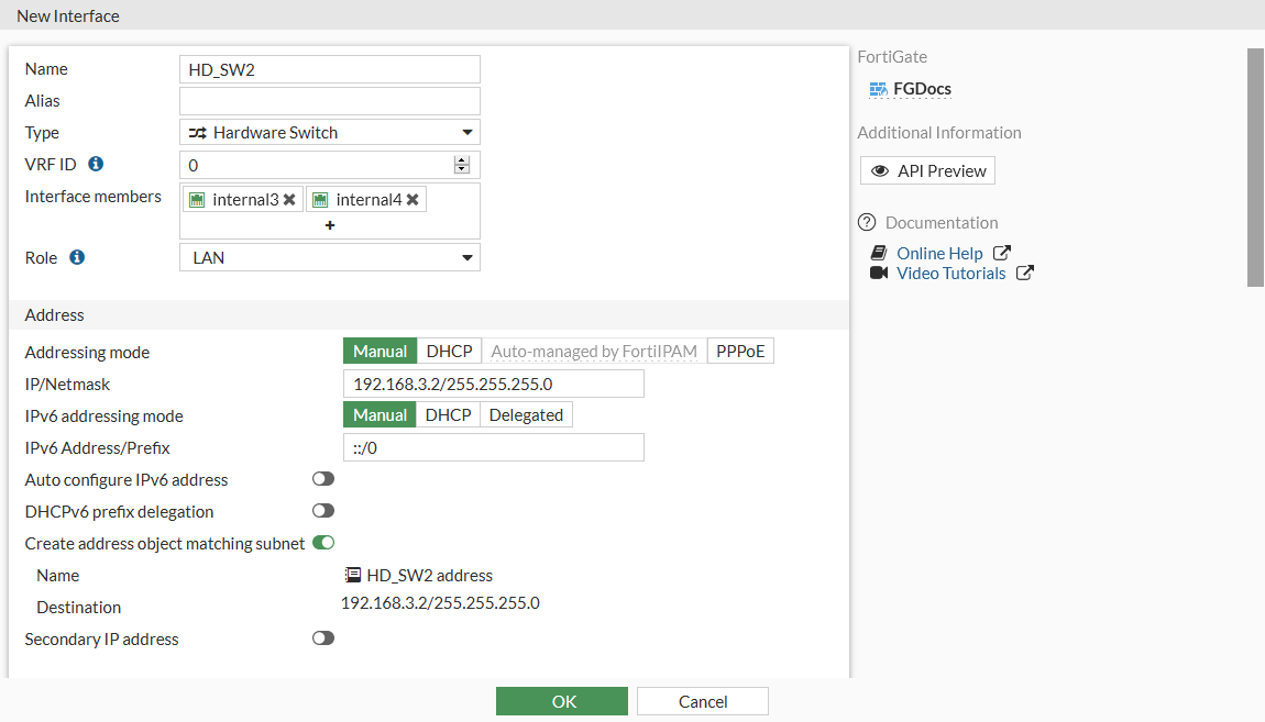

  4. Configure the hardware switch interfaces for the two ISPs:
    1. Go to Network > Interfaces and click Create New > Interface.
    2. Enter a name (HD_SW1).
    3. Set Type to Hardware Switch.
    4. In Interface Members, add two interfaces (internal1 and internal2).
    5. Set IP/Netmask to 192.168.1.2/24.
    6. Configure the remaining settings as needed.
    7. Click OK.
    8. Repeat these steps to create a second hardware switch interface (HD_SW2) with two interface members (internal3 and internal4) and IP/Netmask set to 192.168.3.2/24.
To connect the devices as shown in the topology:
  1. Connect the incoming interface to the internal switch on both FortiGates.
  2. On FGT_A, connect internal1 of HD_SW1 to ISP 1 Router.
  3. On FGT_B, connect internal3 of HD_SW2 to ISP 2 Router.
  4. For HD_SW1, connect FGT_A internal2 directly to FGT_B internal2.
  5. For HD_SW2, connect FGT_A internal4 directly to FGT_B internal4.

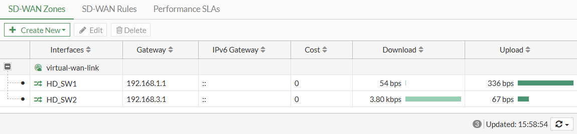

To configure SD-WAN:
The primary FortiGate makes all the SD-WAN decisions.
  1. On the primary FortiGate, go to Network > SD-WAN, select the SD-WAN Zones tab, and click Create New > SD-WAN Member.
  2. In the Interface dropdown, select HD_SW1.
  3. Leave SD-WAN Zone set to virtual-wan-link.
  4. Enter the Gateway address 192.168.1.1.
  5. Click OK.
  6. Repeat these steps to add the second interface (HD_SW2) with the gateway 192.168.3.1.
  7. Click Apply.

In this topology:
HA failover
    4. Click OK.
    7. Click OK.
  5. Click OK.
  7. Click Apply.
