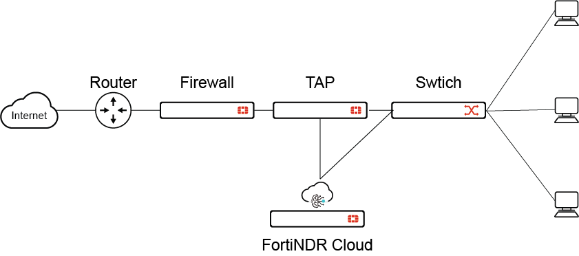

Network TAP
A network TAP (Test Access Point) is a device that connects directly to the cabling infrastructure. Instead of two switches or routers connecting directly to each other, the network TAP sits between the two devices and all data flows through the TAP. Using an internal splitter, the TAP creates a copy of the data for monitoring while the original data continues unimpeded through the network.
This ensures every packet of any size will be copied. This technique also eliminates any chance of subscription overage. Once the data is TAPed, the duplicate copy can be sent to a FortiNDR Cloud sensor.
Inserting a TAP into an existing network link requires a brief cable disconnect. TAPs are typically installed during a maintenance window.
When to consider a network TAP
  • Switch CPU already highly utilized and may drop packets.
  • When additional load on the switch could impact network performance.
  • No ports available on the switch.
  • Hardware does not support SPAN functionality.
  • When legal regulations or corporate compliance mandate that all traffic for a particular segment be monitored.
Not sure which data source(s) to use? Ask your FortiNDR Cloud representative.
