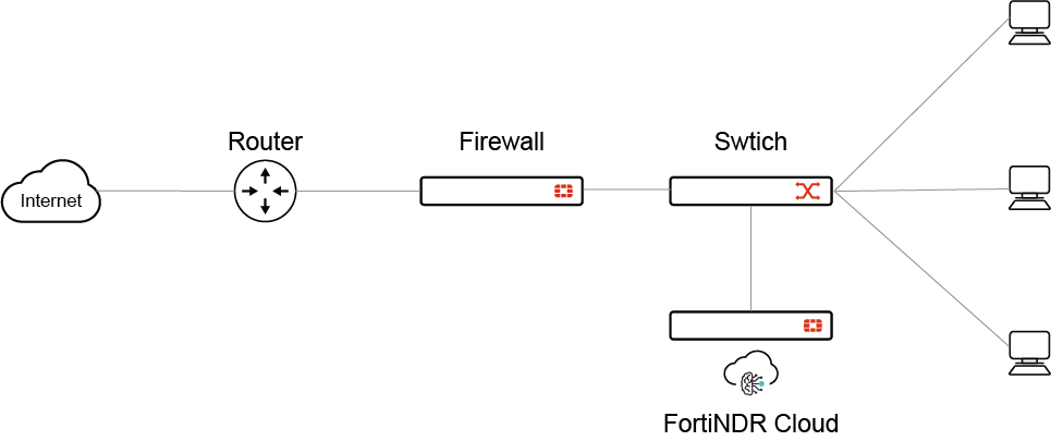

SPAN (mirror) port
A SPAN port (sometimes called a mirror port) is a software feature built into a switch that creates a copy of selected packets passing through the device and sends them to a designated SPAN port. Using software on the network switch, an administrator can easily configure what data is monitored by a FortiNDR Cloud sensor connected to the SPAN port.
If the switch CPU is already heavily utilized prior to configuring a SPAN, SPAN data will likely be given a lower priority on the switch. The SPAN also uses a single egress port to aggregate multiple links, so it may become oversubscribed.
When to consider a SPAN port
  • Limited ad hoc monitoring in locations with SPAN capabilities where a network TAP does not currently exist.
  • Production emergencies where there is no maintenance window in which to install a TAP.
  • Remote locations with modest traffic that cannot justify a full-time TAP on the link.
  • Access to traffic that either stays within a switch or never reaches a physical link where the traffic can be TAPed.
  • Locations with limited light budgets where the split ratio of a TAP may consume too much light.

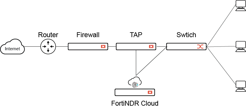

Network TAP
A network TAP (Test Access Point) is a device that connects directly to the cabling infrastructure. Instead of two switches or routers connecting directly to each other, the network TAP sits between the two devices and all data flows through the TAP. Using an internal splitter, the TAP creates a copy of the data for monitoring while the original data continues unimpeded through the network.
This ensures every packet of any size will be copied. This technique also eliminates any chance of subscription overage. Once the data is TAPed, the duplicate copy can be sent to a FortiNDR Cloud sensor.
Inserting a TAP into an existing network link requires a brief cable disconnect. TAPs are typically installed during a maintenance window.
When to consider a network TAP
  • Switch CPU already highly utilized and may drop packets.
  • When additional load on the switch could impact network performance.
  • No ports available on the switch.
  • Hardware does not support SPAN functionality.
  • When legal regulations or corporate compliance mandate that all traffic for a particular segment be monitored.
