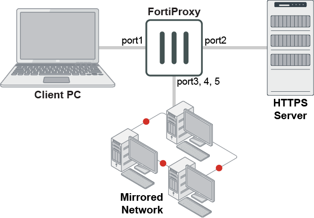

SSL mirroring allows the FortiProxy unit to decrypt and mirror traffic to a designated port. A decrypted traffic mirror profile can be applied to explicit, transparent, SSH tunnel, and SSH proxy policies when the custom-deep-inspection, deep-inspection, or deep-test SSL/SSH inspection security profile is selected.
SSL inspection is automatically enabled when you enable a security profile on the policy configuration page.

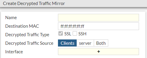

Create New
Select to open the Create Decrypted Traffic Mirror window. See Create or edit a decrypted traffic mirror profile.

Name
The name of the decrypted traffic mirror profile.
Destination MAC
The destination MAC address for the mirrored traffic.
Decrypted Traffic Type
Whether decrypted SSL traffic, decrypted SSH traffic, or both are mirrored.
Decrypted Traffic source
Whether decrypted client-side traffic, decrypted server-side traffic, or both are mirrored.
Interfaces
The interfaces for decrypted traffic to be mirrored.
