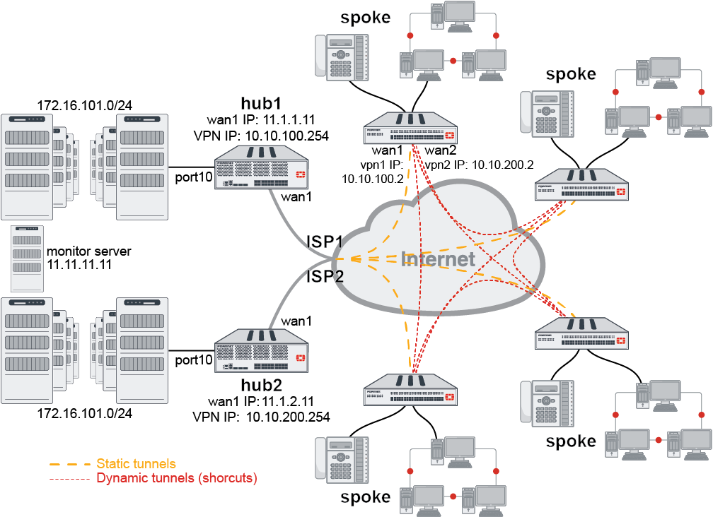

A typical ADVPN configuration with SD-WAN usually has two hubs, and each spoke connects to two ISPs and establishes VPN tunnels with both hubs.
This example shows a hub-and-spoke configuration using two hubs and one spoke:
- Hub1 and Hub2 both use wan1 to connect to the ISPs and port10 to connect to internal network.
- Spoke1 uses wan1 to connect to ISP1 and wan2 to connect to ISP2.
- wan1 sets up VPN to hub1.
- wan2 sets up VPN to hub2.
The SD-WAN is configured on the spoke. It uses the two VPN interfaces as members and two rules to control traffic to headquarters or other spokes using ADVPN VPN interfaces. You can create more rules if required.
For this example:
- Use SD-WAN member 1 (via ISP1) and its dynamic shortcuts for financial department traffic if member 1 meets SLA requirements. If it doesn't meet SLA requirements, it will use SD-WAN member 2 (via ISP2).
- Use SD-WAN member 2 (via ISP2) and its dynamic shortcuts for engineering department traffic.
- Load balance other traffic going to hubs and other spokes between these two members.
- Set up all other traffic to go with their original ISP connection. All other traffic does not go through SD-WAN.

Hub internal network |
172.16.101.0/24 |
Spoke1 internal network |
10.1.100.0/24 |
ADVPN 1 network |
10.10.100.0/24 |
ADVPN 2 network |
10.10.200.0/24 |
Hub1 wan1 IP |
11.1.1.11 |
Hub2 wan1 IP |
11.1.2.11 |
Hub1 VPN IP |
10.10.100.254 |
Hub2 VPN IP |
10.10.200.254 |
Spoke1 to hub1 VPN IP |
10.10.100.2 |
Spoke1 to hub2 VPN IP |
10.10.200.2 |
Ping server in Headquarters |
11.11.11.11 |
Internal subnet of spoke1 |
22.1.1.0/24 |
Internal subnet of spoke2 |
33.1.1.0/24 |
