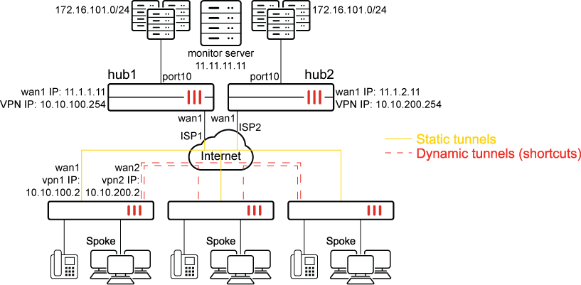

This topic provides an example of how to use SD-WAN and ADVPN together.
ADVPN (Auto Discovery VPN) is an IPsec technology that allows a traditional hub-and-spoke VPN’s spokes to establish dynamic, on-demand, direct tunnels between each other to avoid routing through the topology's hub device. The primary advantage is that it provides full meshing capabilities to a standard hub-and-spoke topology. This greatly reduces the provisioning effort for full spoke-to-spoke low delay reachability, and addresses the scalability issues associated with very large fully meshed VPN networks.
If a customer's head office and branch offices all have two or more internet connections, they can build a dual-hub ADVPN network. Combined with SD-WAN technology, the customer can load-balance traffic to other offices on multiple dynamic tunnels, control specific traffic using specific connections, or choose better performance connections dynamically.

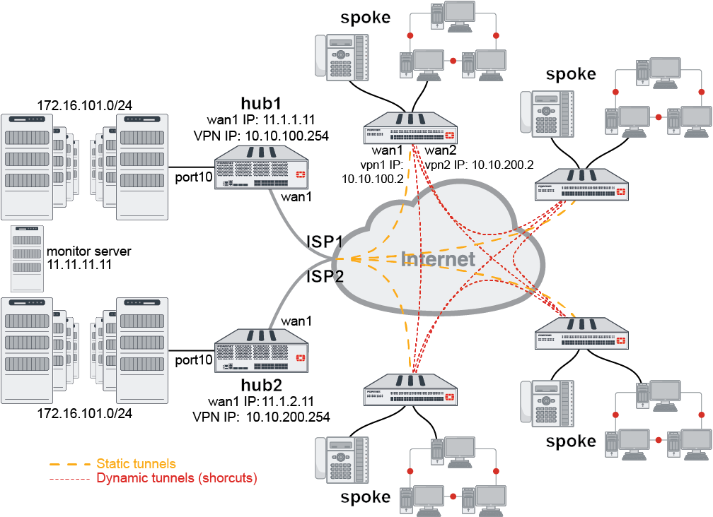

Configuration example
A typical ADVPN configuration with SD-WAN usually has two hubs, and each spoke connects to two ISPs and establishes VPN tunnels with both hubs.
This example shows a hub-and-spoke configuration using two hubs and one spoke:
  • Hub1 and Hub2 both use wan1 to connect to the ISPs and port10 to connect to internal network.
  • Spoke1 uses wan1 to connect to ISP1 and wan2 to connect to ISP2.
  • wan1 sets up VPN to hub1.
  • wan2 sets up VPN to hub2.
The SD-WAN is configured on the spoke. It uses the two VPN interfaces as members and two rules to control traffic to headquarters or other spokes using ADVPN VPN interfaces. You can create more rules if required.
For this example:
  • Use SD-WAN member 1 (via ISP1) and its dynamic shortcuts for financial department traffic if member 1 meets SLA requirements. If it doesn't meet SLA requirements, it will use SD-WAN member 2 (via ISP2).
  • Use SD-WAN member 2 (via ISP2) and its dynamic shortcuts for engineering department traffic.
  • Load balance other traffic going to hubs and other spokes between these two members.
  • Set up all other traffic to go with their original ISP connection. All other traffic does not go through SD-WAN.
  • Set up basic network configuration to let all hubs and spokes connect to their ISPs and the Internet.
Hub internal network
172.16.101.0/24
Spoke1 internal network
10.1.100.0/24
ADVPN 1 network
10.10.100.0/24
ADVPN 2 network
10.10.200.0/24
Hub1 wan1 IP
11.1.1.11
Hub2 wan1 IP
11.1.2.11
Hub1 VPN IP
10.10.100.254
Hub2 VPN IP
10.10.200.254
Spoke1 to hub1 VPN IP
10.10.100.2
Spoke1 to hub2 VPN IP
10.10.200.2
Ping server in Headquarters
11.11.11.11
Internal subnet of spoke1
22.1.1.0/24
Internal subnet of spoke2
33.1.1.0/24
SD-WAN load-balance mode rules (or services) do not support ADVPN members. Other modes' rules, such as SLA and priority, support ADVPN members.
This topic covers three parts:
  1. Configure dual-hub ADVPN with multiple branches.
  2. Configure BGP to exchange routing information among hubs and spokes.
  3. Configure SD-WAN on spoke to do load-balancing and control traffic.
For this example:
172.16.101.0/24
10.1.100.0/24
ADVPN 1 network
10.10.100.0/24
ADVPN 2 network
10.10.200.0/24
Hub1 wan1 IP
11.1.1.11
Hub2 wan1 IP
11.1.2.11
Hub1 VPN IP
10.10.100.254
Hub2 VPN IP
10.10.200.254
10.10.100.2
10.10.200.2
11.11.11.11
22.1.1.0/24
33.1.1.0/24

Hub2 sample configuration
Hub2 configuration is the same as hub1 except the wan1 IP address, VPN interface IP address, and BGP neighbor-range prefix.
To configure the IPsec phase1 and phase2 interface:

Spoke1 sample configuration

To configure the VPN interface and BGP:
config system interface
    edit "spoke1-phase1"
